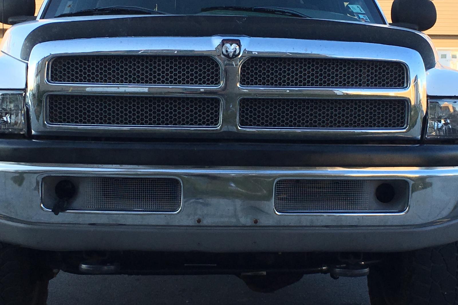

Now you know what I've got hardware mesh zip tied to the grill on the inside and then tuck hardware mesh in the bumper holes. This is to possible prevent object like stones and large bugs like beetles hitting the condenser and bending the fins over. Yeah simple things like this can make huge improvement. For the cheap fix would be to do like @leathermaneod did and carefully straighten out all the fins or the quick way is to just replace the entire condenser for around $100 bucks.
Mine was banged up too but mainly at the bumper. Took a HF fin comb to it and it looks better but not as good as yours @leathermaneod. That took a lot of patience.
Now if you replace the condenser, can you recharge the system yourself with cans from an auto store, or do you need a professional machine? Also, when you say mesh, I assume your talking about like window screen material? or something else? That does sound like a really good idea though, there were and still are quite a lot of little stones in there!
@dripley thanks for the compliment! yes it did take a few hours. I also bought the HF fin comb. Having never used one before, I assumed that getting things cleaned up would be a breeze, especially after watching a vid on youtube. Not so at all! Anything that is bent over more than a little bit will not straighten with the comb. Sometimes the comb even damages them. I basically had to get them all stood up by hand, then just used the comb to clean it up. I also found that the comb works better without the handle :thumb1:
Edited by leathermaneod
This is all I'm using is 1/4" x 1/4" hardware mesh. Little stiffer than window screen and easy to work with. Do not attach any screen to the condenser itself. This will in fact rub holes in the tubing and later cause  leaks in the system. It best to attach the screen to the grill this way it never makes contact to the condenser or tubing.

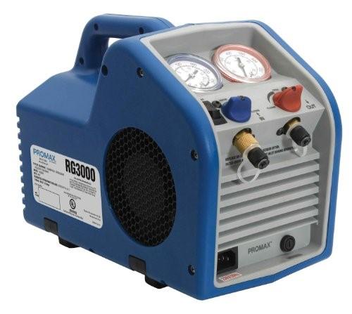

Just looking over the price on reclaiming machines which is outrageous. Like this little guy is nearly $500 and prices go as high as $6,000 for the fancy computer device ones. Most of the machines are not very portable with weights as high as 200 pounds.
Even the simpler one are nothing more that compressor than pumps freon from the system back into a storage vessel. So... Say for example your compressor was low on oil and created a bit "black death" (wear debris) in the system.

its almost impossible to see behind the grill, but it's there! The ones over the holes in the bumper couldn't be secured too well but I'm hoping they will be good enough. My only concern is rust since the wire is galvanized steel....hopefully it doesn't rust too bad at the cuts....at least it was cheap....
