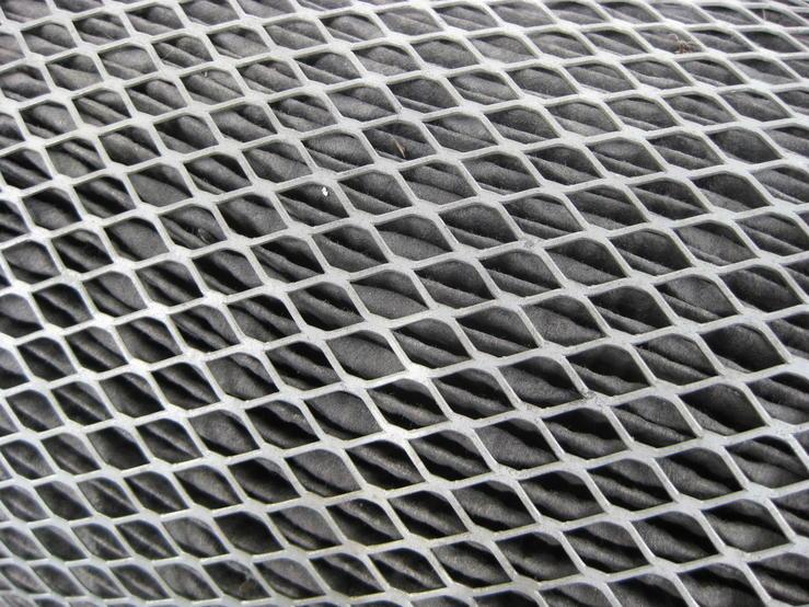

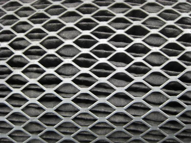

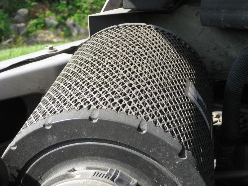

Be careful what you ask for... I just got up from my chair and head right out to the shop and shot the pics and came back in and uploaded them to the site... Here is a 6 year old filter without a Outerwears, no maintenance, and filter filter minder still not moved... http://forum.mopar1973man.com/attachment.php?attachmentid=925 http://forum.mopar1973man.com/attachment.php?attachmentid=924 http://forum.mopar1973man.com/attachment.php?attachmentid=923 http://forum.mopar1973man.com/attachment.php?attachmentid=922 How to test your filter minder... Yes I did have a outerwears for about 1 year but the constant bouncing and rubbing wore holes in the outerwears so I toss it out...

Every year I'm out on dirt road making trips up and down the mountain... http://forum.mopar1973man.com/attachment.php?attachmentid=928
I went out and looked at mine a little closer, and it's already caked with dust. I think this one has only been on it 6 months. Heres some better pics. Mike, yours is a lot cleaner than mine, not sure why, maybe missouri pavement is dirtier than Idaho gravel :lol:
Ae you using any kind of oil or oil treatment on the outerwears? If so quit... :nono: The thing is if there is any kind of oil on the filter it won't shed the dust... That is how mine stays clean. As I go over the washboard road the vibration shakes the dust right off it... I'll have to get a pic of the dust piles in the heat shield in the summer time... Check this out... http://www.filterminder.com/ http://www.filterminder.com/mythvsfact.asp
