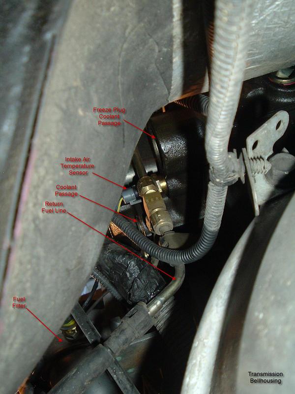

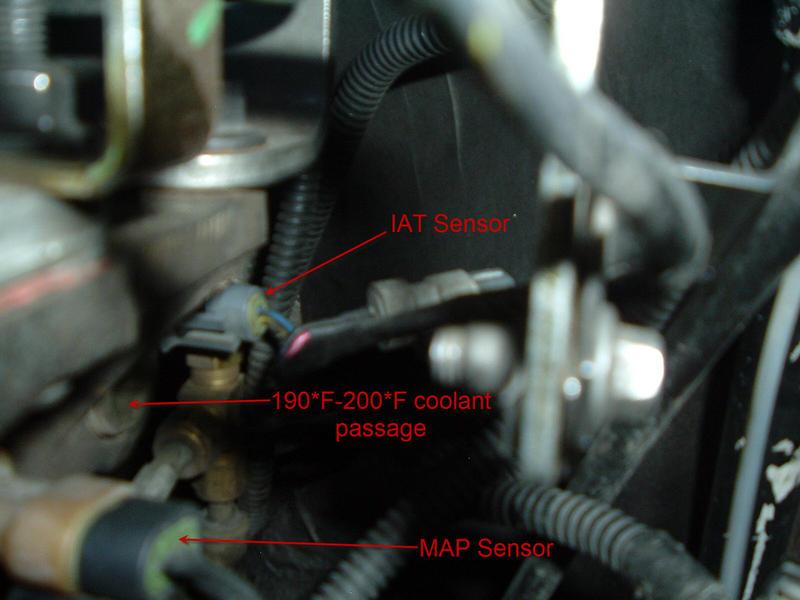

Everyone seems to know the IAT of a 24V, but I never see anything on a 12V. So I cut the IAT wires, soldered wires to them, ran them into the cab, crimped them onto my multimeter leads, and I was able to read Ohms while driving. I am still working on a calculator to see what temps I am seeing but so far here is what I have personally tested, I just need a way to connect the dots for the calc.
