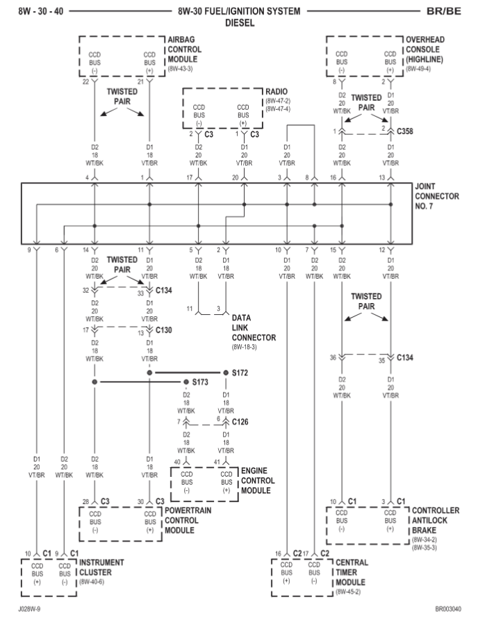

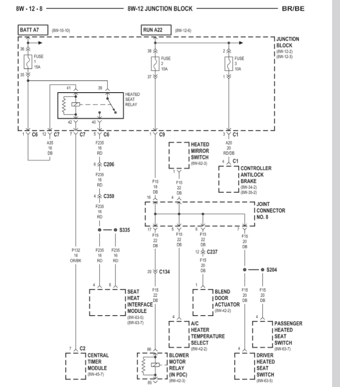

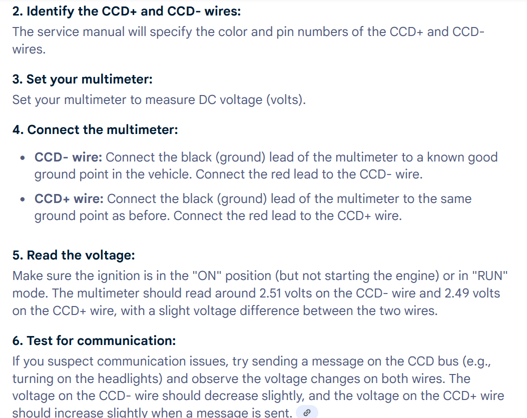

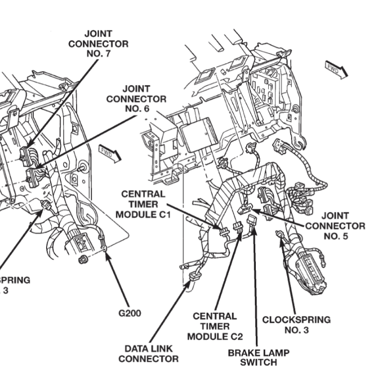

First issue is I get trans limp mode and a P1689 with no buss on the CCD when turning on the HVAC blower at any speed. Once turned off it goes back to normal. I have taken the ground off for the HVAC controls and the no buss issue also happens without the blower motor running only in face vents or floor vents position.
Looking at wiring diagrams I can't tell where any of the HVAC would cross with CCD modules.

  • I suspect that you may have a poor body to frame ground, or poor body to battery ground. Since the blower motor switch grounding and the data link grounding are in the body ground circuit, a poor bod

I believe there are two body-to-battery grounds for the driver side battery. One is located on the body between the driver side battery negative post in the headlight area and I think the other is under the battery tray.
I've seen posts over the years where people have found the ground points mentioned above to be corroded.

As far as I know, there are only two ground connections for the HVAC control panel and the blower motor - ground # 200 and # 201 - both are connected to the dash, just separate locations.
