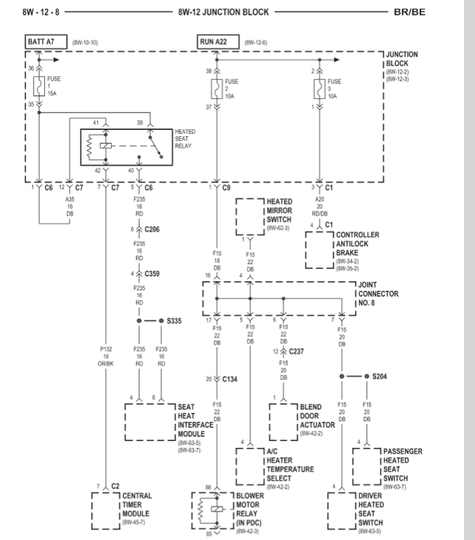

On 5/10/2025 at 5:56 PM, ducktape11 said:
Also I remember that turning on my heated mirrors pops the blower motor fuse. I haven't tried using them for over a year because of that and I couldn't figure out the connection between the mirrors and the blower motor.
Since you mentioned this, I did find a correlation between the heated mirror switch and the blower motor circuit. The 10 amp fuse #2 in the junction block feeds Joint Connector #8 which connects to the mirror heater switch and some other components INCLUDING connection to the coil of the blower motor relay. Was it the #2 fuse in the junction block that blew?
  • John
Yes that is correct fuse 2. Yea looking at the diagrams I finally was able to put the 2 together. Very weird they would be on the same fuse. I figured a blower motor on high and heated mirrors would be over 10a draw.
It is only the blower motor relay coil (#85 and #86) that draws from this fuse. That current draw is less than 200 milli-amps. The switch portion of the relay (#30 to #87) carries the full load for the blower motor - #12 40 amp fuse in the PDC.
Most likely you have a short circuit to ground downstream of the mirror heater switch / relay that is causing the blown fuse when you activate the mirror heater switch. At least you now know where to begin looking for this problem.

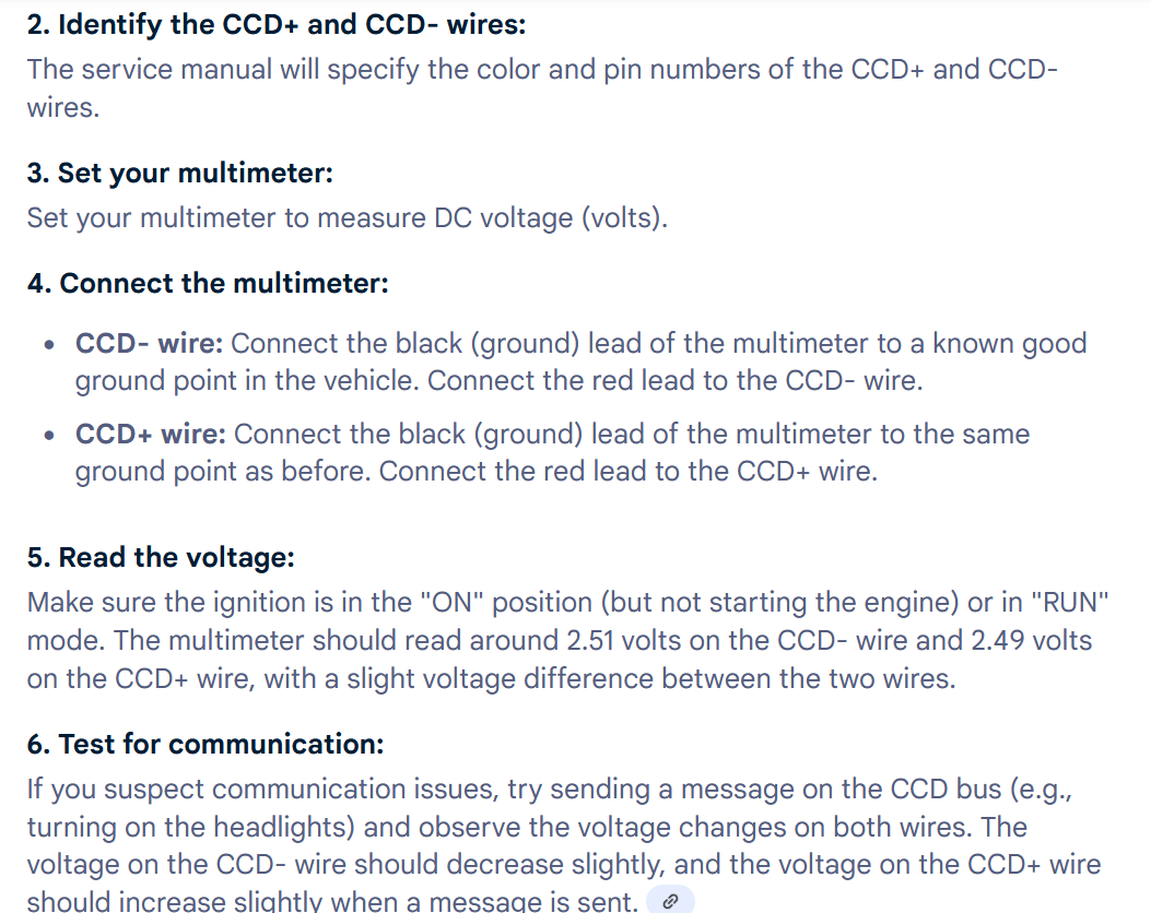

5 hours ago, ducktape11 said:
Disconnecting the fuse, relay, or motor itself at the connector gives the no buss message. To me that means it's power I'm looking for and not ground.
I tend to agree with that conclusion, but I wouldn't rule out a ground issue. Poor grounds can cause irrational behavior and can mess with your mind.
Have you tested the CCD circuit (as described below) while you are making changes in the blower motor circuit? It would be interesting to see if CCD voltage readings reflected a change when the "no buss" message showed.
  • John
Both voltages were low
2.422 and 2.463 if I remember right

I measured the circuits from the data link pins 3 and 11.
46 minutes ago, Mopar1973Man said:
Battery terminals condition?
Ground wires condition?
PDC fuse box weak connection?
Voltage only drops because of weak connections or poor wiring. In other word electrical load is exceeding something in the circuit. Connector with corroded pins, oxidized wiring...
2.460 and 2.420 is what I got with decreasing voltage of about 0.03 with headlights on/off

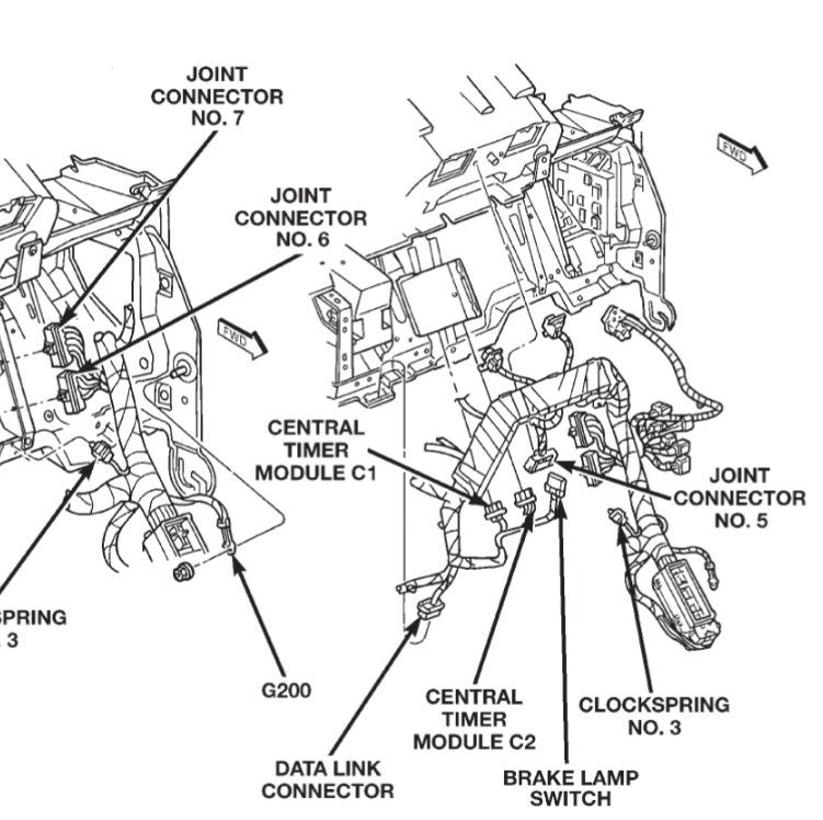

Here is the weird part the head ground is at the driver side kick panel. Head power is from the PDC fuses.
The OBDII port is powered from the IOD fuse in the cab. Then the ground pin uses the same ground at the driver side kick panel.
Then all power is funneled through the PDC power lead to the battery. Might check this electrical and possibly fuses and socket of the fuse. Be aware ive seen fuses crack and test good but do weird things.

I was grounding the meter to the dash. Should I use OBD ground?
Might try that being the dash should be the same but let's see what difference you might get. Oh be sure to allow enough time for the CCD bus to quit talking. True data would be using a oscilloscope to see the bias voltage and any data pulse occurring. Cheap solution to being able to see what is happening.
