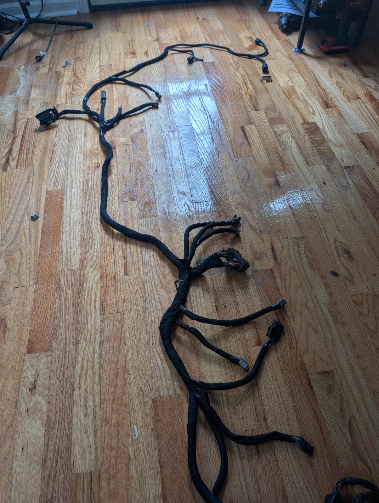

Well, I decided to pull the engine harness. I want to completely strip it down and go through EVERY wire just to eliminate the possibility of it being a harness issue... The amount of man hours I have into this issue is actually insane.
How's the hunt for the short going, have you found anything yet??? I was thinking about doing the same thing for a week or so now. Is it worth it or is it a major pain in the ***?? Let me know, Thanks.
So far I have found nothing! It's not difficult, just time consuming. I have this old power supply that I'm using to help load test the wires!
21 hours ago, Mopar1973Man said:
Auto Computer Specialist does full wiring repairs and testing. Just a tidbit to aid in the adventure.
Good to know! Im a cheap *** and prefer to struggle my way through this LOL.

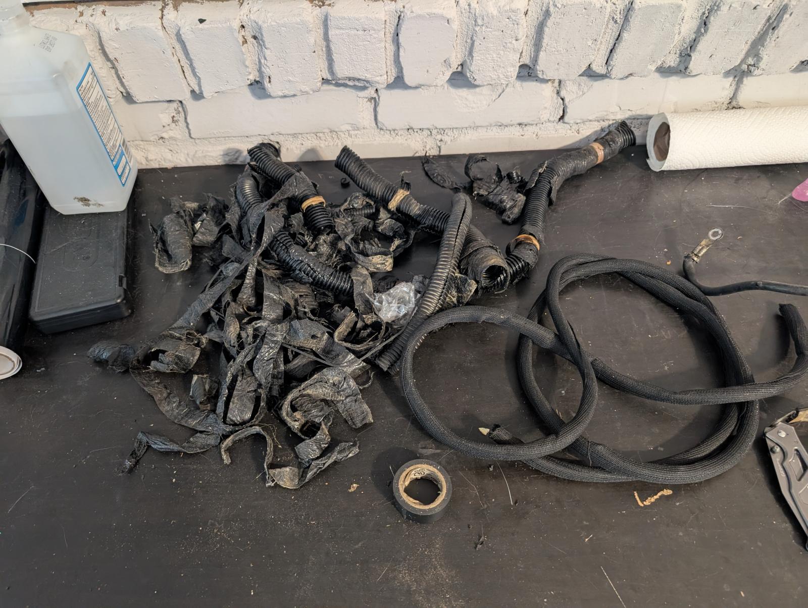

Small update: Been real busy at work and general life events! Sorry! I got the Tesa tape in the mail today and finally had a minute to re-wrap my harness. I've never worked with this stuff before. It goes on easy and looks so professional, and apparently holds up well under engine heat. Only time will tell if that's actually true though!
Look at all that old grimey, brittle and sticky plastic loom. Feels good to get that off of there!

Did you test end-to-end on each, checking for 5 ohms or less? Did you check for wire damage or crushed wires?
Sure did! Resistance tested and load tested every thing. No issues found. No crushed wires, no cut/damaged anything. The mystery continues!
