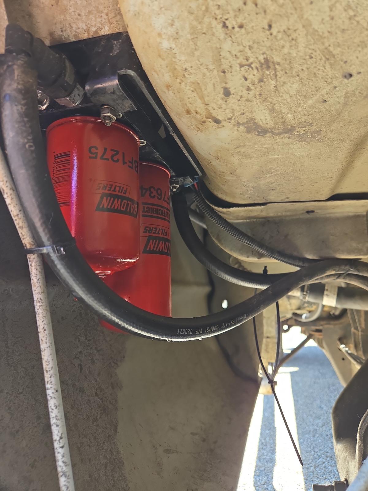

When I started my truck the first time with the new ECM the fuel pressure was at its normal range of 14-15psi. After I shut the truck off I replaced a wire on my switch box and accidentally knocked a wire from the fuel pump relay. When I started it again I noticed I had zero pressure. Thinking I could figure it out quickly, the truck ran out of fuel. Once it was sorted the truck obviously wouldn’t start. I loosened the fass filter and ran the pump until it gushed and then retightened. I then cracked 2 injectors and cranked until they bubbled out fuel. The truck runs but now it takes a a few extra seconds of cranking when cold to start and the fuel pressure gauge doesn’t read until a few seconds after it has started. My pressure is now at 18-19psi. The truck runs and drives fine, not sure what to do.

I need to change the oil this weekend so I’ll crawl around underneath and see if I notice anything.
Double-check any of the suction side lines. Remember, these lines don't typically leak outwards. Being a vacuum allows it to lose its prime. Do you have metal JIC fittings or plastic quick-lock fittings? On those types of fittings, if you suspect a fitting to be leaking air, you can wipe a bit of grease on the smooth bore and leave it a bit thick. This typically fixes an air leak temporarily. Metal fittings you might want to double check the mating faces and make sure there is no damage. These must be smooth both sides! Any bad faces you'll end up replacing both fittings.
I have the metal push lock fittings. I didn’t see anything wet, but it has gotten better. It’s still not as good as it used to be but is starting and building pressure better.

Yeah, those are the ones. I’d really like to replace all my fuel lines as the blue stuff that came with the FASS looks like crap. I’m broke as hell right now though so it will have to wait. I will take a better look at the fittings though, I was supposed to the other day but had so much other stuff going on at the same time I totally forgot.

I think I finally have this fixed. My fuel pressure had been getting very low a few times, 0-5psi. I just replaced all the fuel lines and swapped in a different check ball and spring. The old ball was definitely stuck in the spring, they did not separate as easily as they should have. Fuel pressure is now sitting steady at 13-14psi.
