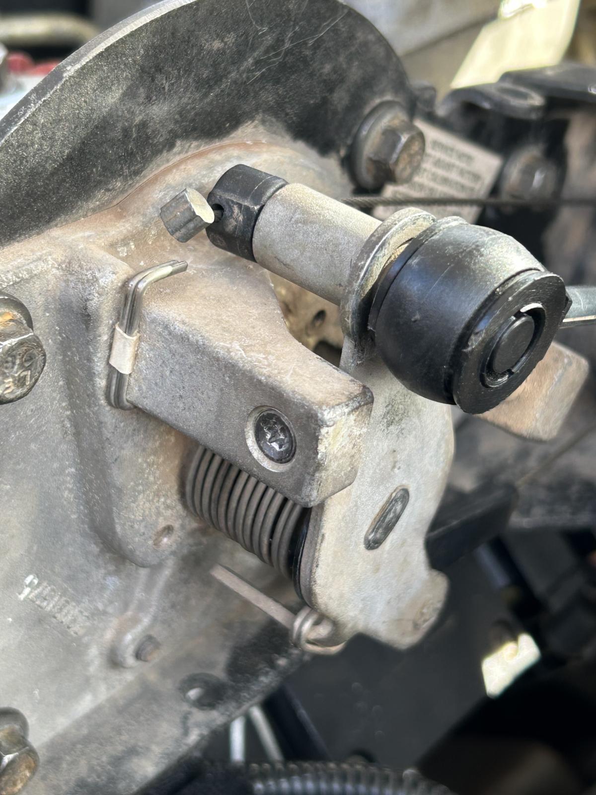

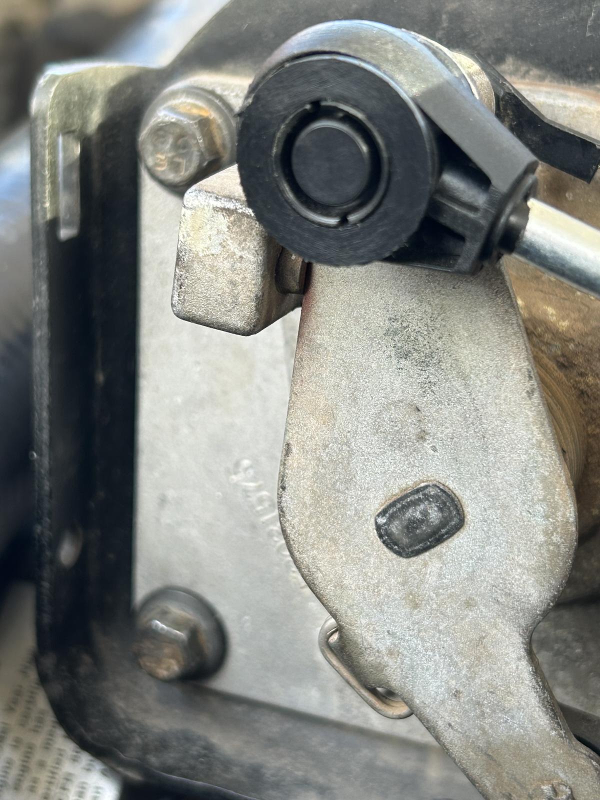

Attached photos of the screw. Unfortunately, it's too secure. I'd tried seeing if I could adjust it before and it just breaks bits.

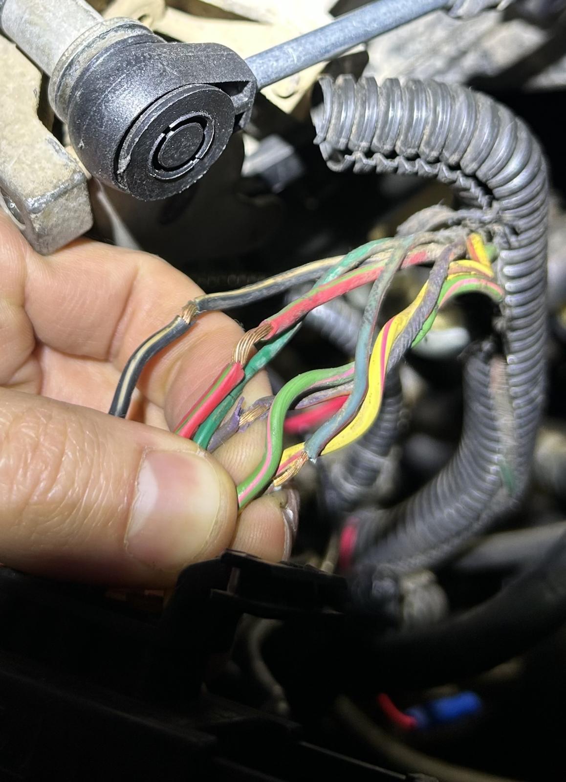

However, the cables are in somewhat rough shape. 4 of the 6 are a bit frayed. The physical wire’s themselves seem ok except the ASD, it has about half the strands cut (a little further up than where most of the bare copper is in the photo)
