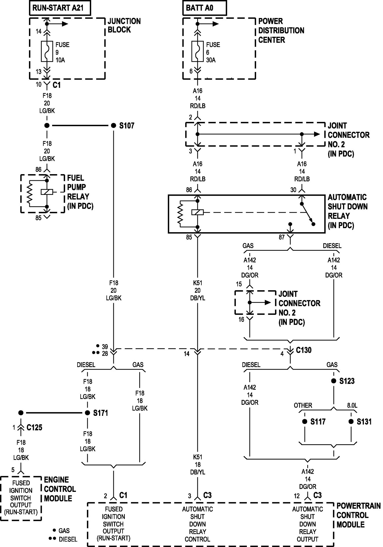

There is a ground wire to the block just above the starter & according to wiring diagrams, it grounds the fuel pump, fuel heater, A/C compressor clutch, & the CAN-BUS ground. The wire terminal seems good & 3 of the 4 connectors have good continuity to ground. I haven’t found the Cummins Can-Bus connector to check that. Diagrams show it’s located on front left of engine & has 3 terminals ( Bus +, Bus -, & ground). I’m unsure of where or how to check that….

Sorry been on the road limited cell service.
My suggestion at this point I would consider contacting Auto Computer Specialist and have the PCM and ECM tested. Something is wrong if the wait to start does light up, fuel pump not bumping at key on. Then the PCM creates the CCD bus so. Wiring on the CCD would need to be checked for sure. Bias voltage is not correct even after removing modules.
