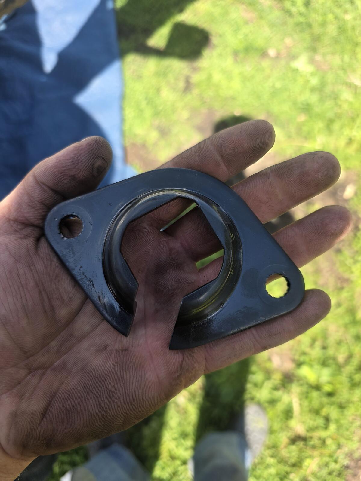

Had the 3 locking tabs on my south bend hyd 1.5 break off yesterday. 2nd one its happens to. I contacted them and they are going to send a "repair bracket" which i guess pinches the master cylinder between the 2 brackets. Does anyone have a part number or link where else I could get this, need one for another truck

I have never heard of this. Could you at least show a photo of what you are talking about, please?

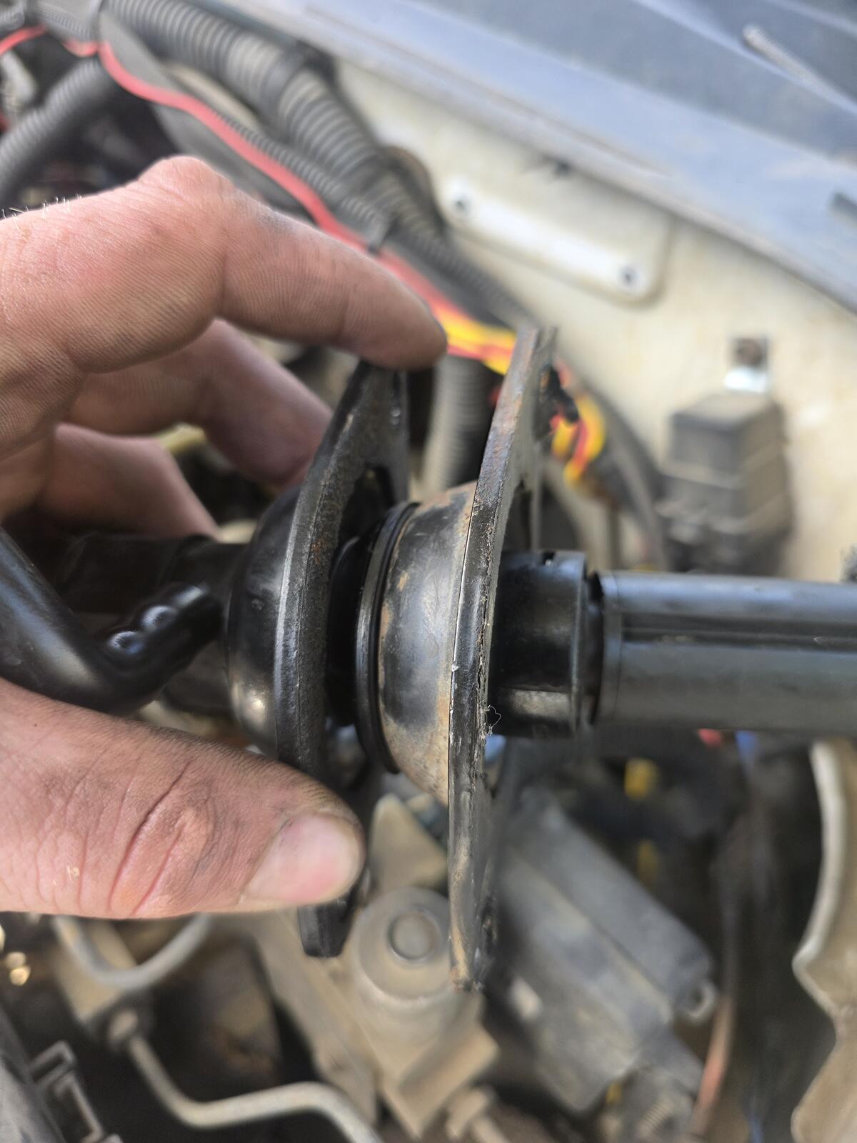

Pictured is the bracket they sent, and how or installs on master cylinder. I had to pound the studs out of the factory bracket and they supplied threaded rod, external tooth washers and nuts to hold both brackets together.

Yeah, the mounting tab to break off means it's a lot of pressure pushing on the hydro's master? I've got to ask whether you over-adjust the rod? There shouldn't be any mechanical force on the master cylinder body unless the over-adjusted rod was allowing the piston to bottom out in the cylinder, causing the break mounting ears. Or is the plastic so weak that constant cycling of the clutch caused it to fail by breaking?

I believe it's just that the plastic got weak. I'm fairly sure that I've got it adjusted correctly according to South bend's instructions.
