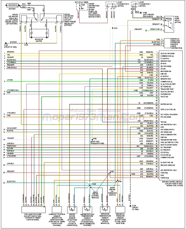

one interesting thing to note, the black with a blue trace wire at each sensor is listed as the sensor ground from ecm, this wire has continuity to battery ground at each sensor but that goes away once the ecm harness is disconnected. Is this normal? I always thought sensor ground and body ground were different? Does the ECM connect body ground to the sensor ground pin internally? I also put my meter from sensor ground at ect to battery ground and thoroughly wiggled the whole harness to see if continuity beep stopped. It di not stop Until i removed ecm plug

Many sensors (as well as the VP44) ground through the ECM - you can see this in the wiring diagram photo below (terminal #11 and #49 on the ECM). Note that Splice #168 (difficult to read, near terminal #49) is also a ground.
