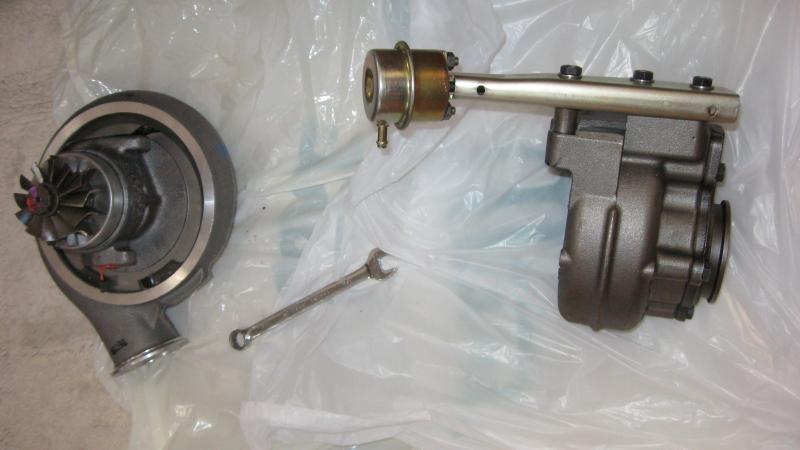

Some pics as I get ready to "clock" the turbo housings post-10132-138698174081_thumb.jpg My good friend jim suggested to remove each component - make alignmnet and installation easier - and I'd say he was spot on :lmao: She looks VERY CLEAN :)
