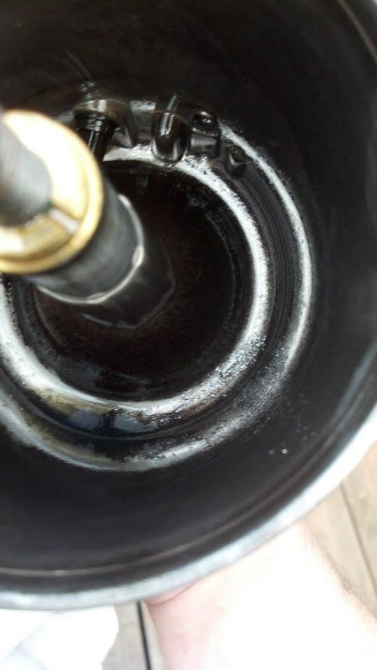

so today i took off the pre filter to check it out. this is what i foundpost-10727-138698185615_thumb.jpgpost-10727-138698185623_thumb.jpgpost-10727-138698185631_thumb.jpgpost-10727-13869818564_thumb.jpgnot exactly sure what was in pic 3. it looks like algae which i guess is possible seeing as how the truck sat a little while. in pic 4 that was a little bit of metal shavings and general dirt. all in all there really wasnt much in there as compared to the fuel filter. i got a great video of start up today and it really chugged for a good few seconds. ill have that posted up in a little bit. i have yet to re install the pre filter, im curious to know if i should check anything else.
Not good. I would take the whole lift pump off and inspect it, only 2 bolts. They are a PITA 2 bolts well the center one is but easy enough. The problem I see is that there is nothing in the prefilter but there are metal shavings in the fuel filter and the only thing between the 2 is the fuel filter housing itself and the lift pump so one of those has to have shed the metal shavings and might be the culprit to where the oil is coming from since the lift pump is in direct contact with oil slinging around. It would be hard pressed to say it is sucking in oil but who knows, I would take it off and inspect it though. The fuel heater/prefilter comes apart moreso as well, you will see when you take the lift pump off since they are kinda attached to each other so you will be taking both out.
not a problem. tomorrow when i come home from work ill take it off. do you thing this could also be the culprit of why i'm getting a tiny bit of air in my fuel system giving me that chug on initial start up.
Maybe. Sometimes the air leaks are a pain to find. It's just really weird that you have oil in the fuel filter. The lift pump really wouldn't be able to ingest oil and be able to pump fuel unless it had some sort of weird crack in the plunger. When you take the lift pump out, you can pull the plunger that rides the cam right out. I usually put a light coating of grease on mine and it seems to help it be quiet, though I think it just gets washed off but you will see what I'm talking about. Actually heres a vid I made a while back.
to be honest i wasnt really concerned with the fuel filter condition, because it sat for so long and i was in question as to if it was ever changed. but now you have me curious, and a bit worried. ill see what i find tomorrow when i pull the lift pump. im hoping that it ends up being my air in fuel problem, i cant even begin to think what else could be letting air in as everything BRAND new and sealed well from tank to pre filter.
They get black over time but that's because they get dirty from whatever is in the diesel fuel. Contaminants and things. NOT oil. Your fuel filter looks the same as mine exept the plastic is not coated in the black film as well and I cannot get oil on my fingers like you did and that is what concerns me. It is oil and not fuel contaminants. If he ran trans fluid in it as an additive or any other kind of oily thing then that might have done it as well. But the metal shavings is really a big concern to me. I forgot to mention you will probably have to take the fuel filter housing off as well (verrry easy) and then you can inspect the bottom of it as well (take the fuel filter off and look). If everything looks fine then the shavings might have been just from him crossthreading the banjo bolt in the housing and shearing some threads and the oil could be a time he forgot about when he added something thick like that. I mean if it all looks perfectly fine then what is there to fix. The air leak isn't really cause for concern too much if everything looks good when you inspect it. Mine chugs when I park it uphill and let it sit, even after replacing every return line copper washer and all the banjo bolt seals. I haven't touched anything behind the engine though so it could be something farther back. It's just one of those things that you can chase your tail forever on.
