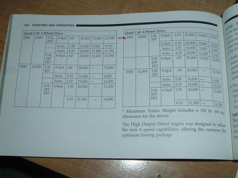

I typically don't use either site or listing I pull out the owners manual which typically has the right answers...post-2-138698198062_thumb.jpgAlso with trailer Dry Weight is meaningless. All weights are scaled weights or GCWR or GVWR. Never use or talk about Dry Weight. Dry weight is used for the shipping industry to ship the trailer from manufacture to dealer that all.Now talk to CajFlynn about this and you'll see a different answer all together.post-2-138698198068_thumb.jpg
I typically don't use either site or listing I pull out the owners manual which typically has the right answers... [ATTACH=CONFIG]5095[/ATTACH] Also with trailer Dry Weight is meaningless. All weights are scaled weights or GCWR or GVWR. Never use or talk about Dry Weight. Dry weight is used for the shipping industry to ship the trailer from manufacture to dealer that all. Now talk to CajFlynn about this and you'll see a different answer all together. [ATTACH=CONFIG]5096[/ATTACH]
HA! Yea, I looked in my owners manual and it wont even list 3.55 gear.... LOOK AT THIS! http://www.cumminsforum.com/forum/towing-hauling/470937-whats-heaviest-youve-towed.html ^ These boys are pulling some extreme loads!
