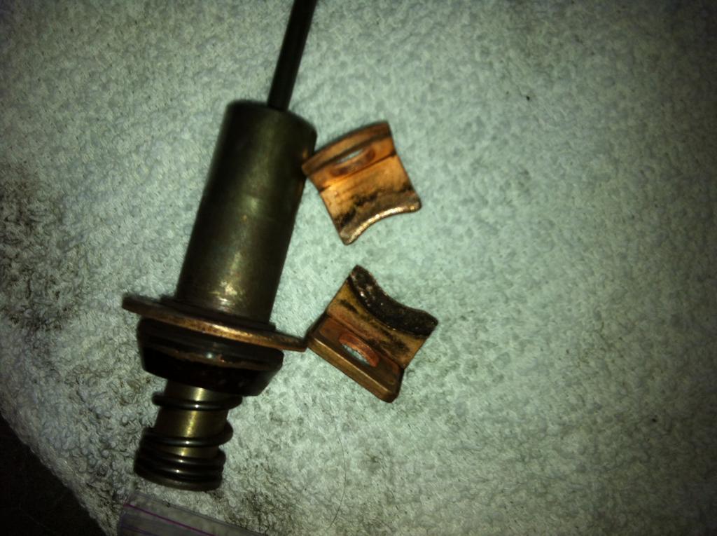

It sounds like the starter contacts wearing out. When mine did it would either start or click once and nothing. It finally just quit starting and I replaced the starter. Problem fixed. You can replace the starter contacts. Try reading thishttp://articles.mopar1973man.com/2nd-generation-24v-dodge-cummins/26-engine-systems/124-starter-contact-replacement

Thanks - I copied the link and it worked. I think this is my issue! Well a picture can tell the story with 97,000 miles bad contact.post-12578-138698200353_thumb.jpg
