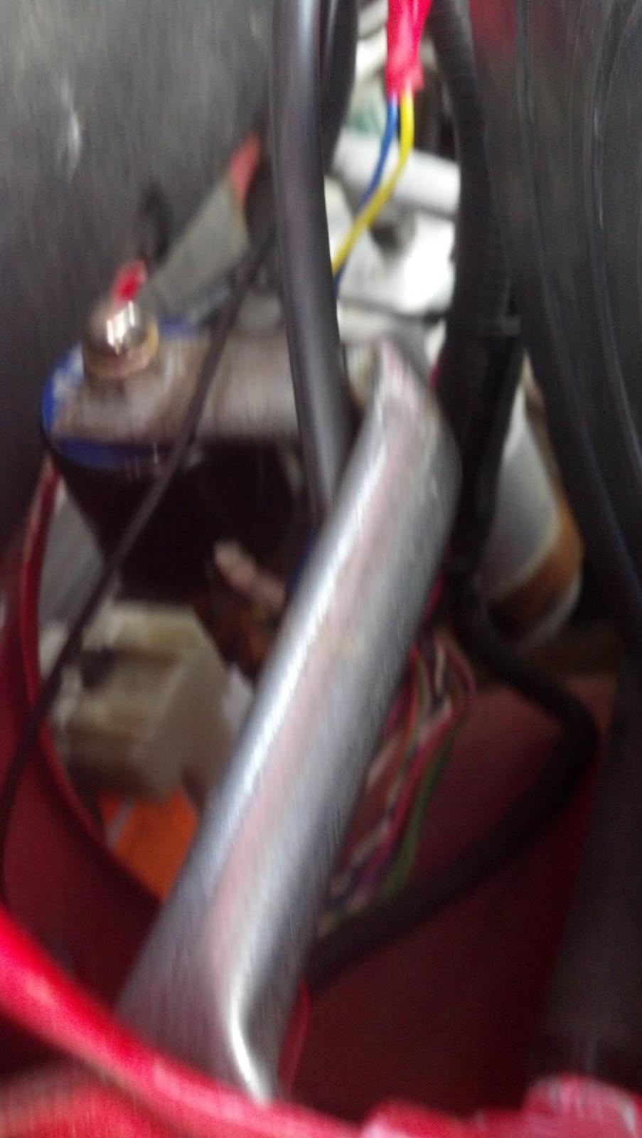

I bought a cheapo 12 volt solenoid off of amazon.com for around 15 bucks. I teed into the vaccum line in the engine compartment before it drops down behind the engine and to the transfer case that way everything stays clean rather than being under the truck and in the salt, mud etc. The solenoid is normally open so the vaccum simply travels through the solenoid and then down to the transfer case until I flip the toggle switch which blocks the flow of vaccum and then I put the t case in 4 lo only now its 2 lo. Its a real simple set up and I had less than 30 bucks into everything. Im sure the kits from BD are nicer. I can take some pics of it if you like.
I like your setup cause its cheap maybe post a pic of solenoid if u can, thanks
post-11861-138698201889_thumb.jpgI made a bracket and bolted it into one of the hood hinge bolts and tucked everything up in front of my air filter that way its out of the way.post-11861-138698201897_thumb.jpgHeres a closer pic of it its hard to get a good shot without removing the air filter.post-11861-138698201914_thumb.jpgThe line my finger is on was the supply for vaccum to my t case. I unplugged the line from the vaccum manifold and ran a section of vaccum line to my solenoid. This is now the supply line to the solenoid valve.post-11861-138698201922_thumb.jpgComing out of the solenoid valve I ran another section of vaccum line back to the line that runs down behind the engine and into the tcase. So I basically made a loop and when i need 4 lo I simply flip my toggle switch which interrupts the vaccum and then move the t case lever to 4 lo and I now have 4 lo. Like I said its a very cheap alternative and probably not nearly as nice as the kits you can buy but it does work.Just make sure if you do this you get a solenoid that is normally open, otherwise you would have to have it energized all the time to keep the flow of vaccum to the t case and CAD.post-11861-138698201929_thumb.jpgI chose to mount my toggle switch way down low instead of somewhere up on the dash. I didnt want to drill any holes in the dash and this is down near the t case lever anyhow, so it seemed like a good spot. I made sure to locate it in a spot where it cant get kicked accidentally.
Thanks a lot I'm going to do this for sure
