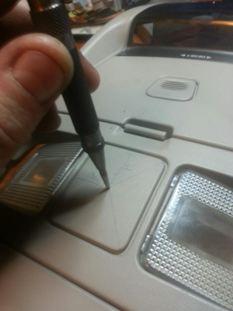

From the corners draw lines to find the center then verify with the above measurements.  Measure and measure again.
User a Center Punch to set the middle for the drill bit.  ENSURE that you are perfectly centered.   If this center is not perfect your faceplate WILL NOT FIT.

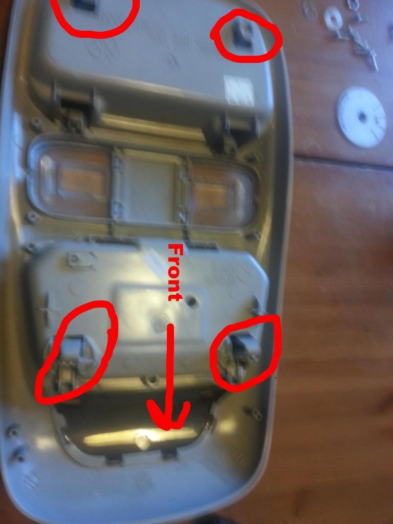

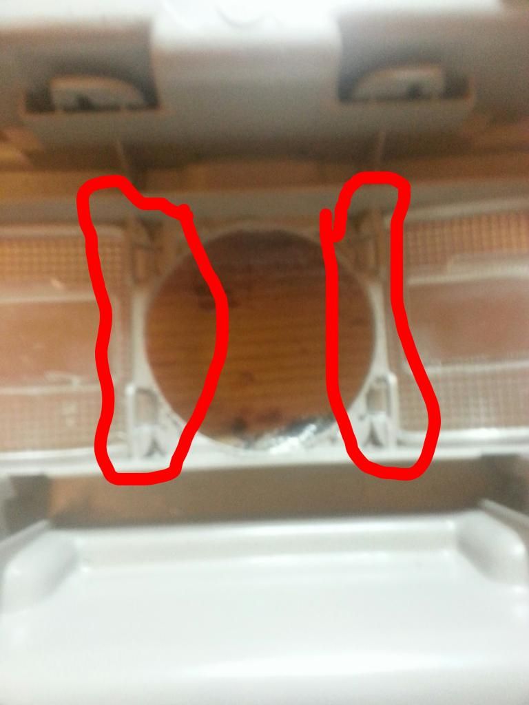

Once the hole is cut flip over the overhead console and verify that the clip section for the lens is intact.  If you notice any breaks glue them back together.  You may need to remove the lens to ensure you don't loose the functionality of the button press lights by gluing them shut.
IMG_20140121_17160_edit_1390349780537_zp
