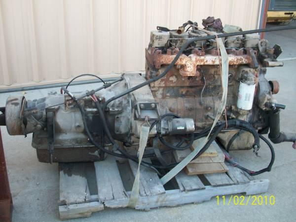

I found this one on a craigslist ad, it said it came out of a freightliner thought. But you can see the engine mount on the side of the bell housing.
