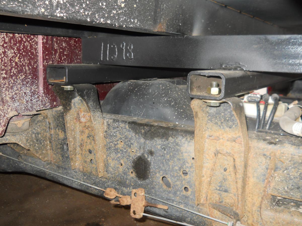

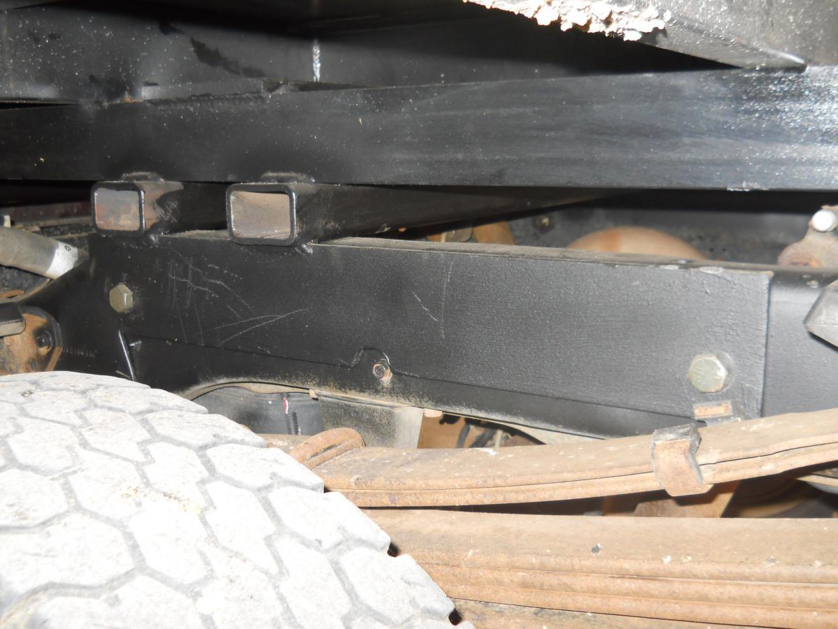

Basically I used 6 'stringers' of 2X3X 1/4 rectangular tubing, and used the original box mounting holes. I welded the tubing to the channels of the flatbed. The extra 2 stringers were tied in with the gooseneck hitch area, welded to 3/8ths plate, and then THOSE were bolted to the existing frame holes (right beside the tires)..

This pic is the rear section, using the 2x3x 1/4 rectangle tubing. They are welded permanently to the 'c' channel on the flatbed, and uses 5/8ths bolts through the original box mounting holes on the frame. The 'foward' of the two shown, is smashed a little. The truck frame has a slight bubble "UP" at this point, meaning the tops of the tube wouldn't be even. All the rest of the tubes came out even.

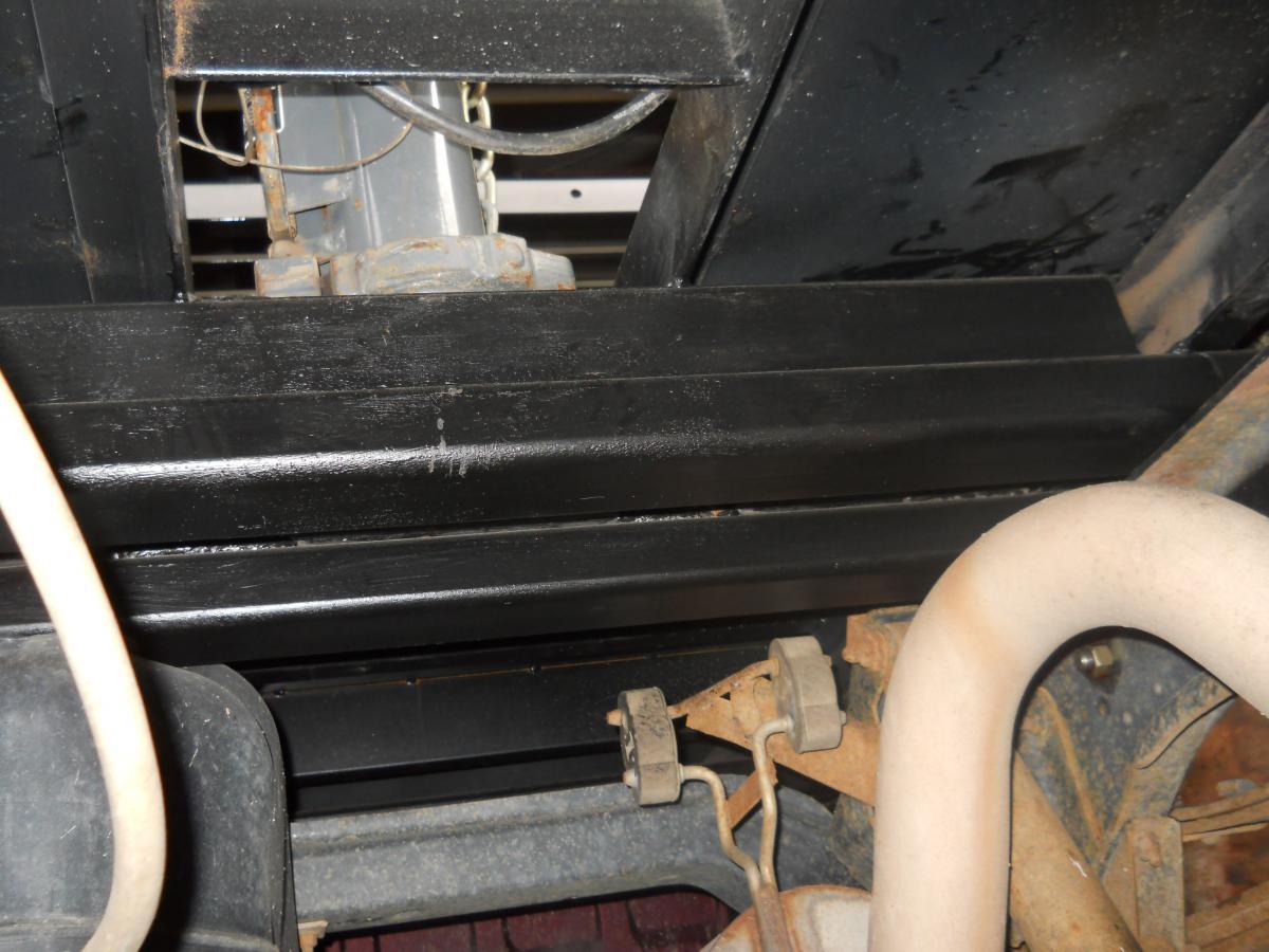

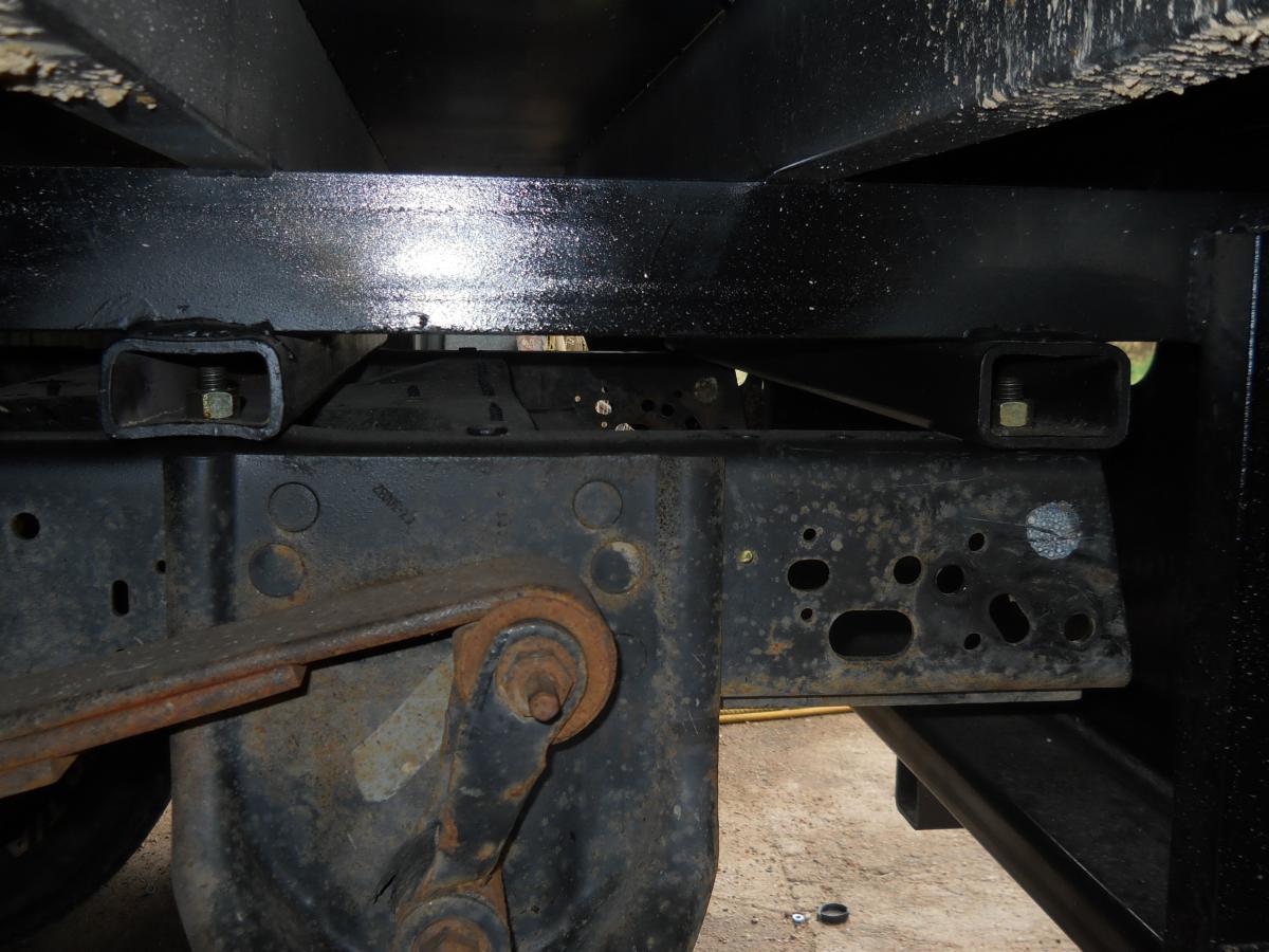

This pic shows the middle pair of stringers. This is the part that 'ties' in the actual hitch plate (gooseneck ball) to the frame of the truck. Again, the 2X3 tubing, with more tubing 'stacked' up to the 1/2 inch ball plate. I used 3/8ths plate welded to the stringers, and used existing 5/8ths holes already in the truck frame. This whole mess is permanently welded to the flatbed. Notice the 'notch' at bottom of plate.. to clear the brake line attaching bolt.. Might be handy to put a wrench on it someday!
This is a shot of the view looking upwards to the opening for the ball. Showing the 'stacking' of the tubing, which ties the original ball plate into the stringers. This dude is solid.
Finally, the forward 2 stringers. same tubing, welded to the C channel, and re using the original box mounts. Theoretically, I could pop the 12 bolts, and remove the whole system and re attach to another Dodge of same vintage.. 12 5/8ths bolts hold the whole contraption down, I didn't use lock washers. I used loc-tite and grade 8 flat washers. Lock washers tend to spin out/break.. and then you've got a loose fastener.
DOT is getting pretty snarly about what is getting drilled or welded on our pickups frames. Reusing existing holes is a safe bet.
