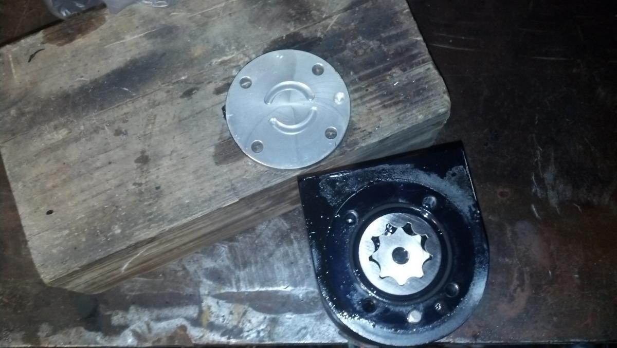

Alright, for all of you that have Air Dog. This is what I found when I tore my AD apart to find where the fuel was leaking from. I have to say that it's not all that bad of quality, but also this is one of the first ones too. It seems to be built pretty well and by the looks of it has a lot of life left in most of components. In pictures you will see the part that failed is a little seal that keeps fuel from coming in to electric motor, and there is a little hole for fuel to come outside when that seal fails. That seal also says made in Taiwan and appears to be damaged back in assembly line ( don't think it's in US, but maybe ). Other than that seal, everything else inside looked good and brushes that I thought would be worn had a lot of life left in them too. I took pictures with my phone so not sure how they will look on screen. I did try to zoom in on part #'s for future. So basically I'm glad I got a new FASS, (supposedly 98% made in USA), (hopefully that little seal too) ,  I don't think I'll find that little seal anytime fast for Air Dog, and AD people won't help. Enjoy the pictures.
P.S. I really think that Air Dog and FASS both should sell these little parts to their costumers. They are screwing us over for $5 worth of parts. It won't be any harder to rebuilt than an alternator or a vacuum pump.

It also looked like that same hole fuel comes out, water can go back in if you power wash it. Notice some corrosion on the bearing and where it sits, also tiny groves from the seal. I think the only thing holding fuel from coming in to stator and armature when seal fails is that sealed bearing, it's pushed in to it's hole with o-ring so fuel has to go through the bearing it self.

Oh man don't get mad, after shoveling snow I went and pupped that thing out and you were right   031072 is the number. here is few more pictures. Also that seal is pressed in against another o-ring, same size that is between gear rotor block and base plate.

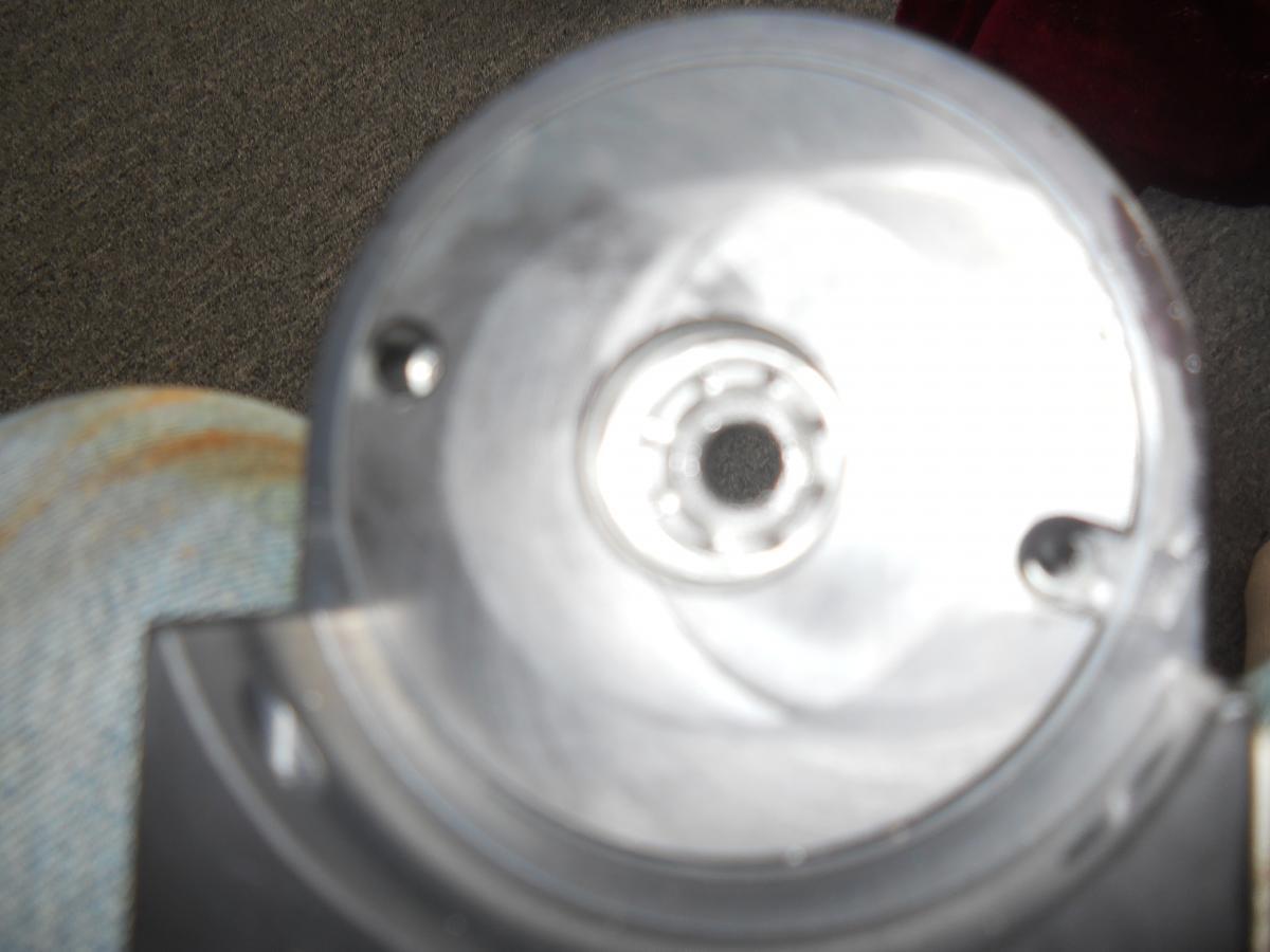

Ok, got mine apart, and this is what I got;
This ad 100 has -0- hours.
I found the little star washer that is used to hold the seal in place was 'off center' half the little tangs on the star were just sitting in the bore, the opposing half were bent up. If that washer was putting any side pressure on the seal, It may cause it to wear pretty quickly in one spot.
I didn't pull it out, cause as you all know, those one-way washers might be junk for the next trip back in.

here's mine with -0- hours.
Sorry for the fuzzy pics. I was probably 4 inches too close!
I found the little star washer that holds the seal in place, 'off center'. half the little tabs that bite into the housing were straight, the opposing side tabs were bent up pretty severely. If that was putting any side pressure on the seal, it may have ate it up pretty quickly.post-980-0-51166100-1422822420_thumb.jpg post-980-0-45560600-1422822910_thumb.jpg
I didn't knock the seal out, I was a little afraid to force that star washer out and expect it to hold next time. Those little tabs were bit into the aluminum pretty deep.
Seal appears to be just a solid thick seal,(the 'rubber' is about 1/4 inch thick, same as the seal housing) and the pressure side has a slightly smaller diameter, forming the seal lip. I'd say the motor shaft would be in full contact with the whole depth of the seal.
