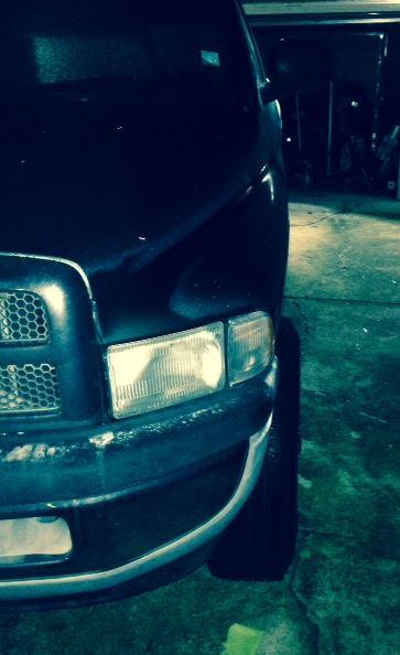

I like the rims and the rear fit well, but the front look like they stick out a little.
Edited by Philo Beddoe
They definitely don't stick out 2" though with the offset of the wheels, at least from what I can see.
Would love to see a shot in the daylight when you get a chance! Thanks for being a pioneer!
