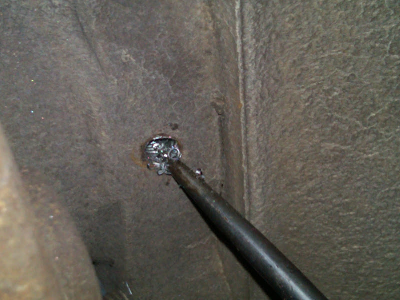

NO  boldness here mike!   I snagged that off the   link  I  showed  in  previous  post!
After   diesel4life   mentioned  he  relubed his  after  inadvertently  separating his  bearing,   and  said  'us with abs'  could do it  easily,   I searched  this   topic and found  that  post about drilling!

and   I  should've said  it appeared to be drilled in the  square part of the housing.
