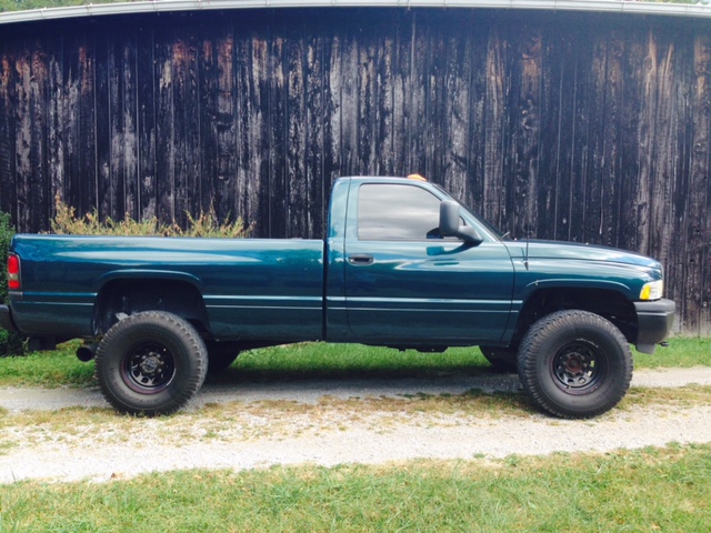

  6. I didn’t have an in tank pump either, mine was originally up by the filter housing. I simply disconnected power to it, and left it. the only thing in tank was the fuel level float and basket. I don’t recall all the steps to it but basically I removed the factory pickup tube and replaced it with a 1/2” ID draw straw. There is a billet aluminum adapter that goes on top of the original mount, you then attach your outlet line to it accordingly, it can be spun 360* to allow you to run your lines as you see fit. Kinda the same for the return, just on a smalller scale. I will try to find some pictures if I have any. If not, I’m going to be pulling my bed off here soon to do some cleanup work and check all my lines for abrasions and I will take DK e pics then and post them. Somewhere on here and CF I did a review of the assassin, but I don’t recall if those pictures were in it or not.
  7. I am not using the hard lines, I ran new 1/2” line all the way forward and back for the return. My dual filter is setup outside the rail and is only visible either from a distance or as in the picture standing downhill of the truck. I built a bracket that I mounted to the rail, and then the filter bracket mounts to it. It allowed me to put it up where I wanted it, thus keeping fuel lines in better locations. Eye level would be about mid door to get this part of the filters to show.
