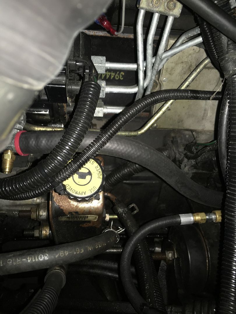

So I got the new parts from Eric yesterday, and got right to work swapping things out. This is what my setup looks like
It isn't quite the way I wanted it, the hose is against the power steering reservoir and I didn't want that. But I may just have to live with it because I may have finally got it to stop leaking. Its SO hard to get the swivel nut to turn without the whole elbow turning. Im still not sure if I've got it or not. Basically spent all morning loosening and tightening and going for a drive over and over and over again trying to get them to seal up but they just won't. I can't believe how tight I've had to make these things! I don't get what issue is. I didn't have any trouble at all when I first go the big line kit. And the only thing thats different now is the route the hose takes. Before I had it kind of up and over the PS cap, and now its like you see in the pics. I did that because it was a pain the way it was before when flushing the PS fluid. Any advice guys? The only other thing I can think of is to take everything off and clean all the mating surfaces with scotch bright then clean everything with brake cleaner and compressed air and start all over again.
Wait so it is NOT leaking anymore?
If it's not leaking I'd say just leave it. Mine is really close to the top of the power steering cap as well. I just left it, I can still just barely get the cap off so it's not worth it to fool around trying to move the T.
You really have to start with the T as counter-clockwise as possible then tighten down.
I'm not sure if it's leaking anymore or not. I'm really not happy with it though. I left the 90°s on the old hose so I think I'm going to put it back together with the old fittings and clean everything with scotch brite and see what happens. There's got to be something wrong. There's no way it's right for these to be this tight.
I can tell you that when I was tightening down the bolt at the VP I had to get it uncomfortably tight a couple times. But mainly what I would do is leave it somewhat loose (like loose enough where it would spit fuel but enough to where I knew it'd leak) and start the truck then just tighten until it's not leaking anymore and then another little snug turn just to make sure and call it good.

If its not leaking then leave it alone.  Looks fine. :thumbup2:  Pour some warm/hot water on everything (that isnt electrical) and let it dry.  The hot water will wash all the residual diesel off.

It was still leaking :mad: and it was physically impossible for me to tighten the one at the vp anymore. It was so tight I almost couldn't get it off. I understand what your saying about making it tighter than you like, but believe me, this was over the top. Something was wrong. I cleaned up the ends with scotch brite and switched back to the old fittings and the original routing of the hose, I think it puts a little less tension on the fittings this way. I never had trouble with leaks till I change the angle of the hose so at this point it's worth a try anyway. I'm just waiting overnight for the 545 to dry again and then I'll be finding out tomorrow if it's fixed or not.
