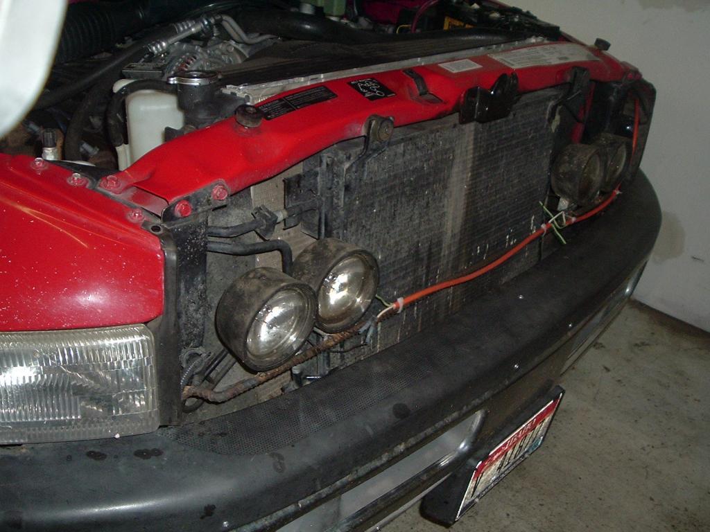

My method of doing it...
http-~~-//www.youtube.com/watch?v=e0TfquTPNX8
Posted Image
[ATTACH=CONFIG]5163[/ATTACH]
Posted Image
So, are you showing the connection points on the fuse box and adding relays somewhere else? With the kind of connector you used at the hi/low connection, there is no relay in the position, but you're using a connector at the trailer relay that allows the relay to be maintained there?
What I do is gain my on/off trigger from the trailer relay. That leg becomes hot (+12V) in either parking light position or headlight position. So this triggers on the fog lamps anytime the headlight switch is in any ON position. As for the fog lamp socket that particular pin happens to be +12V when on low beam and 0 Volts on high beam so this provides toggle for hi/lo position fog lamps which follows most traffic laws of only having 4 lights lit while on the highway. So there is 2 headlights and 2 fog lamps which follow the dimmer switch and follow the headlight mode without adding more switches. If the headlight where last on hi beam and you switch to parking lamps then automatically the fog lamps drop to lo beam mode because of the fog lamp lead. The only added switch I placed in the system is to disable the fog lamps all together so you could have true just parking lamp mode.
