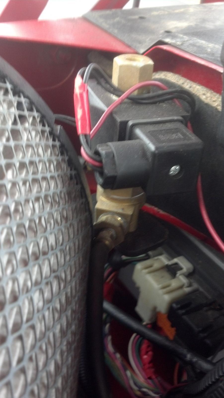

Pic of the solenoid valve. I made a simple bracket out of 1/2" conduit, flattened the ends and drilled holes though them for mounting and used one of the bolts for the hood hinge to secure it. Just one of several ways to mount it. I came out of the valve with barbed fittings to make the connection to the vacuum lines simple.

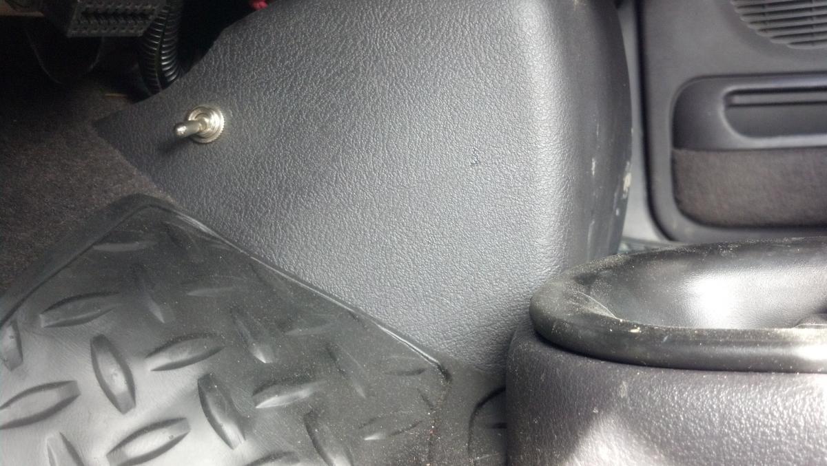

Two way toggle switch to actuate valve. I mounted it down low and out of the way as I really don't need it very often. It is mounted under the cup holder.

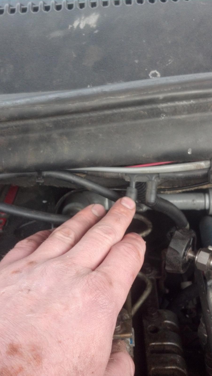

This is where the vacuum line comes out of the manifold and drops down to the tcase and supplies vacuum for the cad. I disconnected it here and ran it through the valve and then back down to the tcase. The valve is a normally open valve so under normal circumstances vacuum flows through it so when I shift into 4wheel drive high or low everything works as normal. If I want 2low I have to flip the switch first to interrupt the flow of vaccum and then engage the tcase into 4low.
It's a very simple set up, probably not as fancy as the disconnect kit you can buy but not a bad alternative if your on a budget or you just want to save a few bucks. I bought the valve from a local industrial supply company but I know they are available online as well. Around $40 for the valve, $10 for a toggle switch and a few feet of vacuum line along with some wiring and your all set.
http://www.dudadiesel.com/choose_item.php?id=2W04008KN
This is very similar to what I have but not exact. A few things you should look for are 1) a normally open valve configuration, 2) a continuous duty solenoid will give you longer service life but is not an absolute must, and 3) a 2 way valve will open and close with minimal pressure/vacuum. Some valve configurations require pressure to open so read up on the specs before you buy anything.
Also most solenoids come in either 120v or 12v so make sure you select a 12v solenoid.
