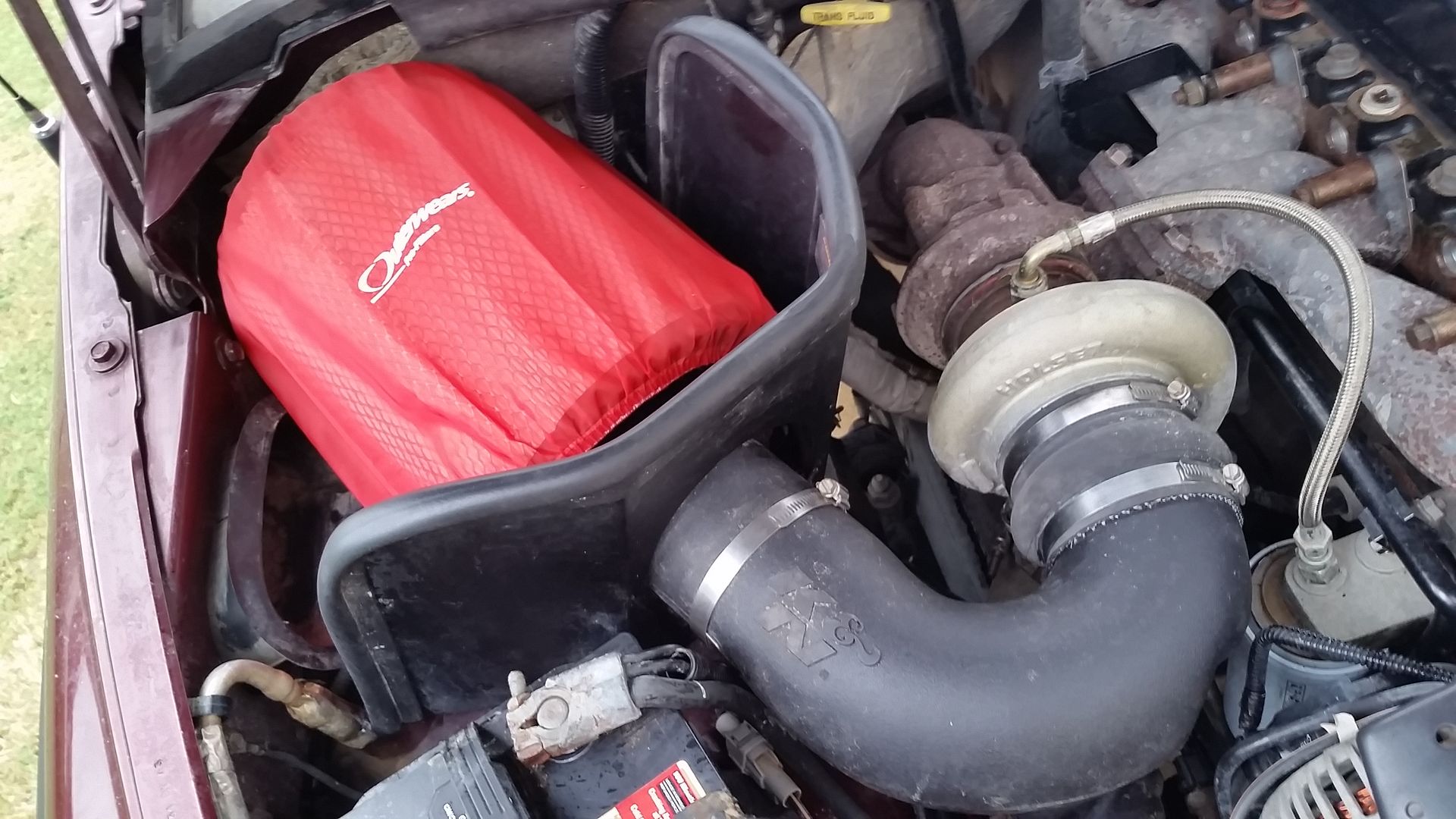

So I'm picking up my truck, with its new VP44 on Tuesday and will be making a 12 hour drive with in on the following Sunday.
As I was looking my truck over before sending it off, I noticed way too much residue in the mouth of my Turbo.  Considering that I run a K&N, I was pretty surprised. Then I started reading around here and my Turbo looks pretty much like the one in Mopar73's article about BHAF.
What I'm wondering is if I can use the tubin setup and heat shield from my K&N and get a BHAF to fit into the space?
If anyone has done this or knows about the size dimentions, I'd really appreciate it.
Normally, I'd just go get a filter and give it a go but, just coming out of a layoff and the expense of the new VP44, I just don't have a play around budget.
Any and all help is highly appreciated.

Getting rid of the K&N and swapping over was a perfect fit. Heat shield and all.
Found the filter and cover at Amazon which totaled $80ish shipped to my front door.
Thanks for all the help and the great discussion.
Looking really good there Doc.
Hope she feels strong.
Looks like something good came out of the K&N set up. It does look good. I ran a K&N for quite a while in the stock filter box. Had a little oil in my turbo mostly on the blades. Nothing like what you had though.
Looking good. Just checked mine it still looks good after 3 years.
