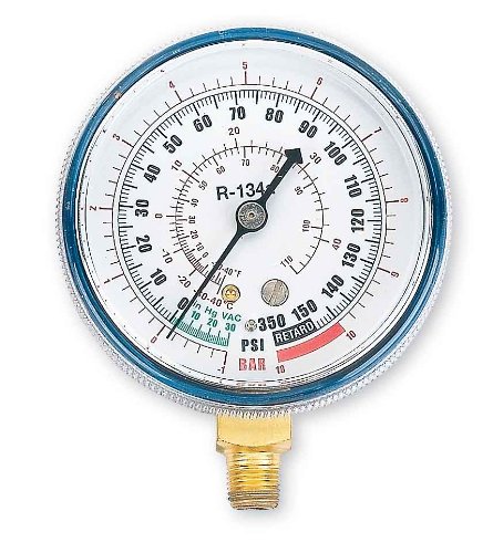

That's why I love my manifold set. I can read both the hi and lo side pressure making the best choices in pressure based on temperature. I typically place a thermometer in the vent and monitor better the manifold and the thermometer. Now @leathermaneod secret to said. The lower the lo side pressure colder it will become but... You need to have enough low side pressure to prevent cycling of the compressor. I can tell you that Dodge's lo side switch is about 25 PSI for cut out pressure. So typically I aim for about 30-35 PSI on the lo side. This will prevent excessive cycling while driving which you can see if you have a second person raise the RPM's to 1,500 RPM or so. The pressure will drop again on the lo side.
I'm a little confused Mike, are you saying I should set high idle or have someone hold it at 1500 and then attemp to charge it again? My compressor was staying locked at this point, but I couldn't get the pressure above 25 psi....
No. Just bring the RPM's up and see what your pressure are like. See if the compressor is going to excessive cycle out. Remember you DRIVE your truck not IDLE in parking lots. So the A/C should be charged enough to prevent excessive cycling. Now under normal operation eventually it will cool the cab to the point you turning down the fan speed. Now I except the compressor to cycle because the evaporator temperature will fall even more. So the lo side pressures typically fall more. Then mild cycling of the compressor will occur because of excessive cold temperaure and prevent freezing of the evaporator.
To see this happen roll up the windows let the cab cool on MAX A/C and now turn the fan speed to low and watch the lo side pressure it will fall to about 25 PSI and kick out the compressor. Look at the inner ring you'll see the discharge temperature is just below freezing. Optimally you want enough freon to keep the evaporator sweating. Hence why I normally head towards 35-40 PSI so when the vehicle is driven the lo side as close as possible to the freeze point without trip the lo side cutout.
