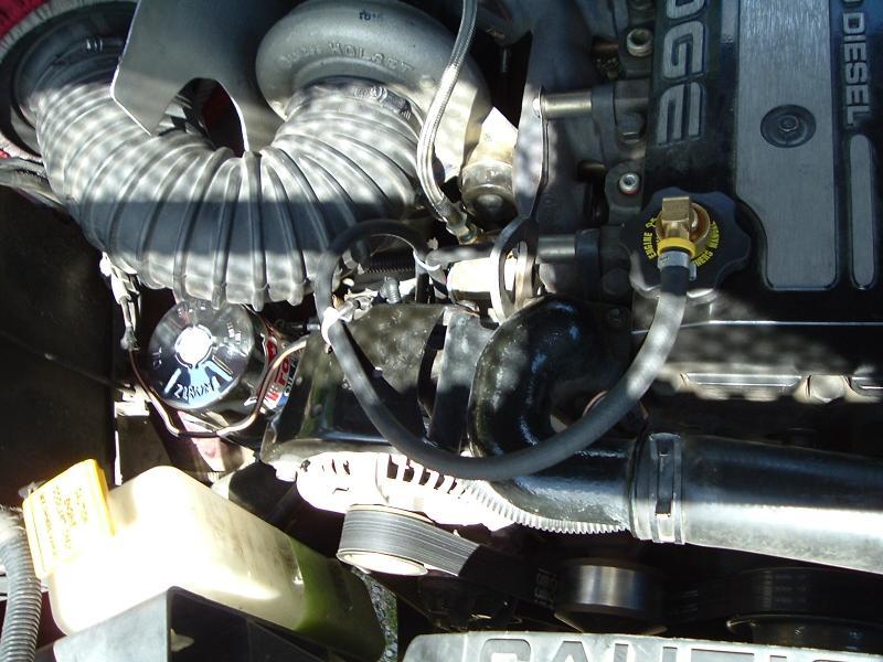

Well with the Frantz Filter it gets oil feed from the oil filter housing and returns it back to the oil cap on the valve cover. So you can remove the setup anytime you wish.
For my MotorGuard bypass, I have the oil returned to the pan via the STHB (Self-Tapping Hollow Bolt). According to Ralph Wood (Mr. MotorGuard) the STHB used to be supplied with the Frantz bypass system. Don't know if it still is. I've not heard of it happening on a Cummins engine, but I went with the STHB because I didn't want to risk "misting" the oil via returning it to the valve cover or the cap. I'll see if I can dig up a picture of my return line to the pan.post-7-138698177201_thumb.jpg[ATTACH=CONFIG]2730[/ATTACH]
