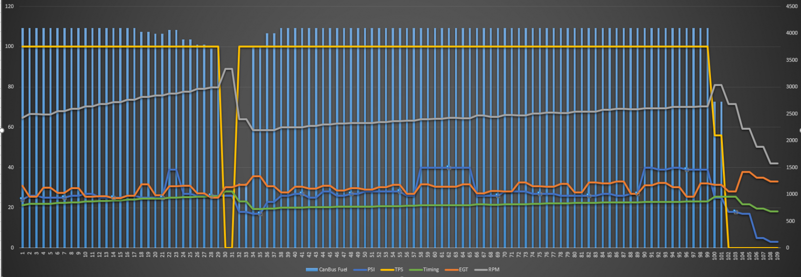

Any idea as to why my boost tops at 27 psi? Can you see that in the data log? Do I need more timing on the top?

Looking through your logs I dont see TPS input great than ~%40 so I can't comment much on the psi only being 27 max.   Ensure you are going WOT.

I think you either have a bad map sensor or your wastegate is opening randomly.  you are hitting 40 psi of boost but only for a few seconds then it comes back down to 26 psi.
I am gonna guess wastegate issues, note how boost jumps 3 times in the log
Alrigh, one thing to mention is that during this run I did have the egt defuel set to 1400. Could that have caused it to drop?
I will check out the wastegate and see what I can come up with.
Doesn't look like it.
I see fueling stable when boost climbs, but then boost just falls out.  I really think the wastegate is opening.
So, if I pull and plug the reference line to the waste gate it should stay closed correct? Just to verify it's the waste gate?
not if the wastegate itself is damaged.
Do you have a boost elbow installed?
Yes. It is turned all the way in.
FYI, once i know I can go over 40 I will set the tune to defule at 35 to be safe. Lol
Won't that also mean I need to drop my boost scaling to 35?
same thing,  I see boost climbing to 40 then dropping back to 27 without any change in the fueling or timing.  Still looks like the wastegate is popping open.
