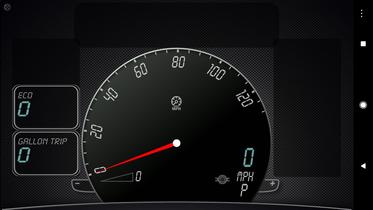

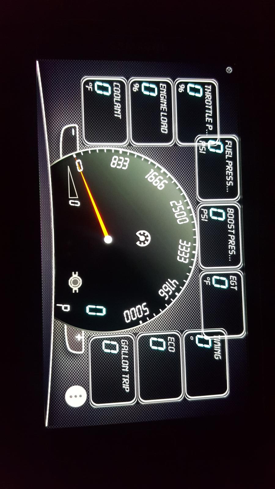

Talked with @Quadzilla Power today about the 2.7 beta -> final move.  We both decided that the boost offset feature was causing more trouble than it was worth.   we have reverted how the late model trucks read  boost to using the 13 psi offset.    The way the truck drives is perfectly fine if idle psi is 0, 1, or 2 psi.   It is annoying but trying to solve the issue just complicates things more than most are willing to work with.
the mpg trip and mpg meter +  improved handoff stayed in place.
