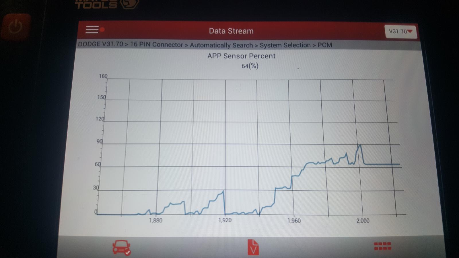

Better off watching the live data from the ECM. Ohm values don't mean much. You should see 0 to 100 prevent throttle signal. Rising smoothly. This can be done without driving.
On the live data we found the TPS all over the chart.  Looked like watching a heart monitor when I put it on the graph mode.  Replaced the TPS and we are getting the same results.
The TPS will read constant when only about 1/8 of the way depressing peddle.  The truck seems to run fine at that point.  If you mash the peddle any further the readings go all over the chart.

Graph of apps sensor percent.  Wide open is 65%
We unplugged the first wire bundle closest to the drivers side and apps is smooth.  The graph looks perfect between apps percent and apps voltage.  And we are getting 100 percent on apps.

I'm going to have to lean on the idea that you've got a damaged PCM. You saying you already getting a PCM abnormal error. Then where you unplugged the PCM the APPS signal returns to normal. Like I said I would have to lean on the idea PCM is malfunctioning.
