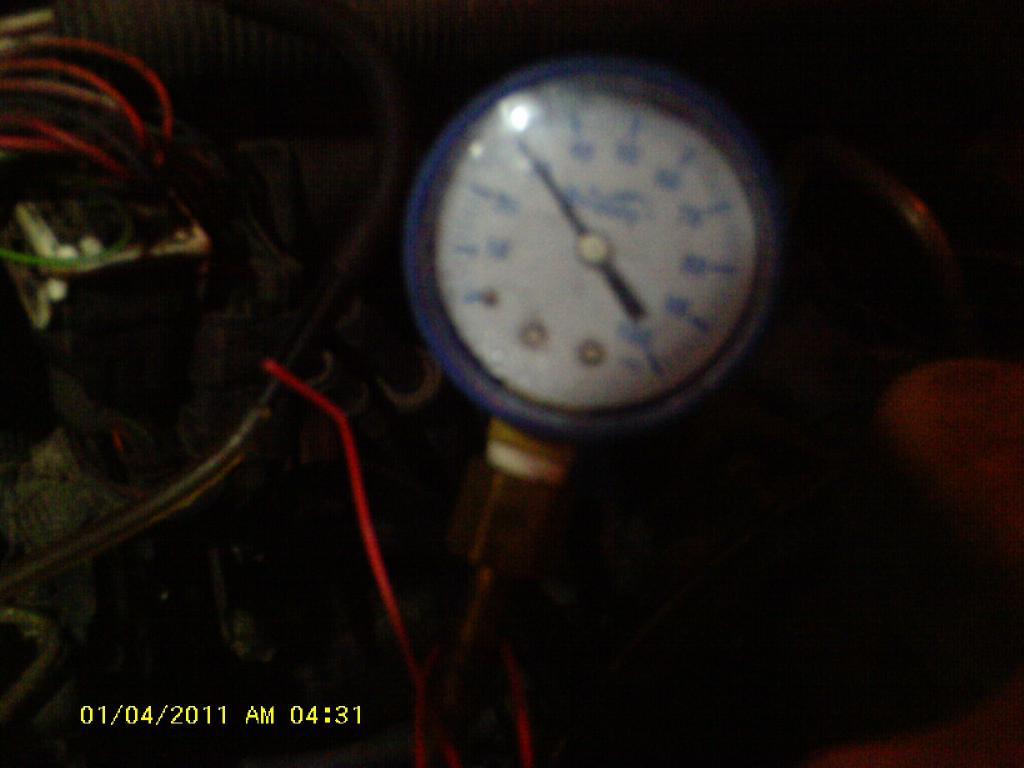

just did a boost leak test and had a bunch of leaks when you get it up to 30 LBS every thing leaks .the two terminal to the air intake heater started leaking @ 25 LBSi used a 4" gem cap and set the clamp about a 1/16" on to the back side of the barb on the turbo when you tighten it down it forces it back and gets it in really tight .used a 1/8" pipe tee and a schrader valve with a gauge fast and simple i have a crappy video but it is to large to upload sorry about bad pics its dark out side and lights cast shadowspost-12593-138698199319_thumb.jpg
