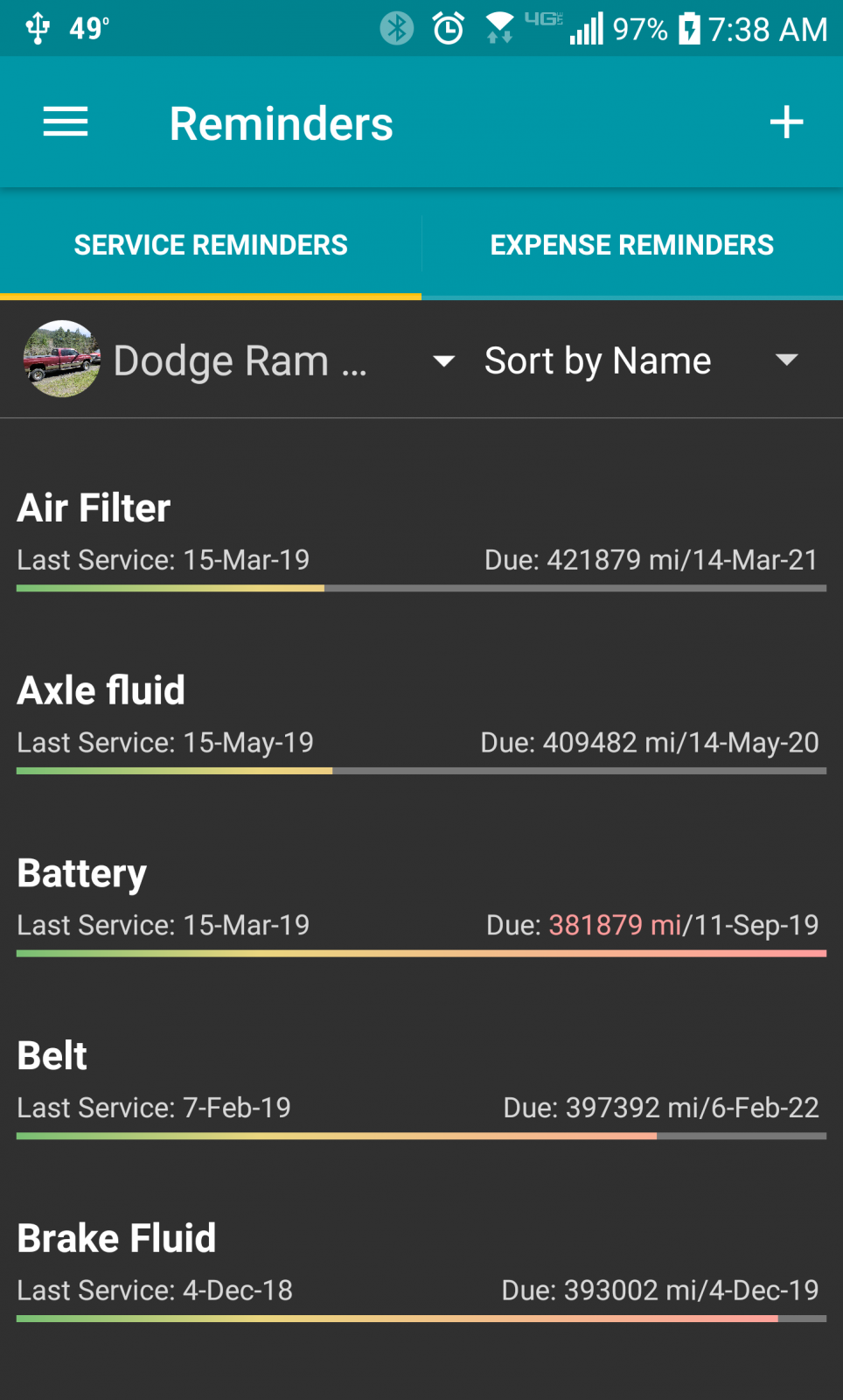

What app are you using to track maintenance.  Can you run multiple cars on it and fuel mileage.
Simply Auto...
https://www.simplyauto.app/
Yes you can run more than one vehicle. I paid for the $4 version and working excellent. Can even back up your logs to a Excel sheet (LibreCalc for Linux). Like I currently log both my 1996 Dodge and the 2002 Dodge. The diesel I've got over 4 years of fuel logs just about and still working good. Maintenance notices will pop up after filling the tank when time or mileage is exceeded.
