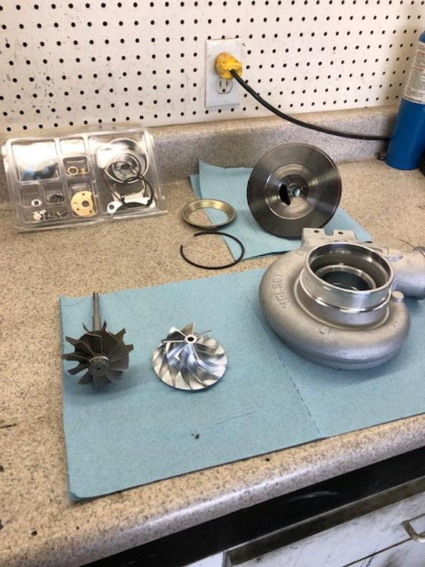

I did a billet wheel 60mm compressor with a 10 blade 64mm turbine and opened up my 12cm hotside to accommodate.  I love it... pulls hard and only spools about 200 rpm slower than the hx35.
