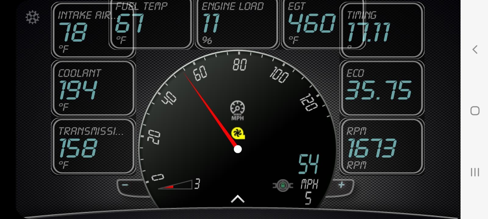

Cool as it gets cruising the highway for EGT's.
Wow, that is some good egt's. On the injectors, you recommend replacing crossover tubes? I just went with the o'rings.
Edited by jlwelding
@Mopar1973Man, what is your boost at in regards to the screenshot? I'm asking because I think I made my own version of your zero boost tune.. Wondering how much of that if any went into your current tune(s).
