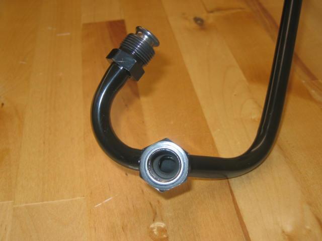

This would be the coolant lines...
B
This would be what I'm looking for.  Replacement of the mess that comes off the coolant ports on the HE.
Edited by IBMobile
remove duplicate diagrams

Yes, I actually just bought one for good measure, I'm in the process of replacing the cooling system in its entirety.
https://www.amazon.com/Replacement-3935812-1998-2002-Cummins-Transmission/dp/B078NJK53D?fbclid=IwAR1lSSExUZFR4JsQpPxHlihsAkfE2OHl6UFydDAxooOg8jEZAeNv73KSg0w

Are your lines ok on the coolant side.  I believe my son's will need replaced and cannot find them at a reasonable price.  IB found some but they were VERY expensive and may just need to make my own or take the old one's somewhere and have then bend new lines.
Bruce
$410?!?!?  Holy smokes.

Surprisingly they are sill in good shape, I did have to replace the output line a one point, but I bought it from the dealership. I'm not sure what is reasonable anymore haha, I just pay it if it makes sense.
that's cheap compared to the $2,000 that they want for an OEM one!
