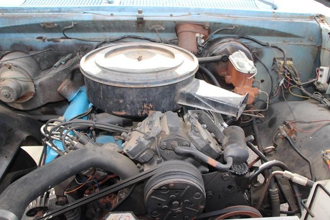

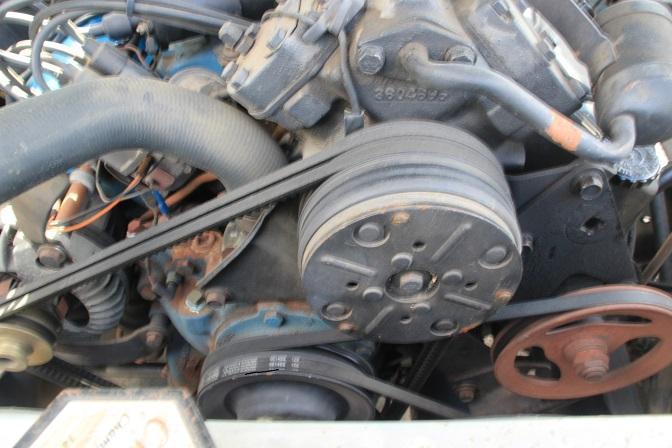

Does anyone have an older 60’s though early 80’s 318/360 that has  power steering and an alternator?   I need pics of the brackets that hold them on.  We are putting a 1972 318 from an RV into a 1959 Plymouth Fury and we tossed most of the RV stuff because it was really funky looking and now we can’t seem to get anything else to line up.  We’ve gone to junkyards and tried googling images but can’t seem to find what we need.

Alternator is on the passenger side then the power steering pump was low on the driver side of the block. If I could see the bracket I could assemble it easy.

Wow, that’s totally different from the other setups I’ve seen.
@IBMobile-Isnt your photo of a big block, 400 or 440? I believe small block mopar has a rear distributor.

I going by what my friend told me, a 360.  Maybe I didn't hear him right or had a senior moment.  I'll check with him tomorrow.
He's right I didn't pay attention to the front mounted distributor. That is a big block. 383, 400, 413, 426 or 440. My Charger had a 383 Big Block.
