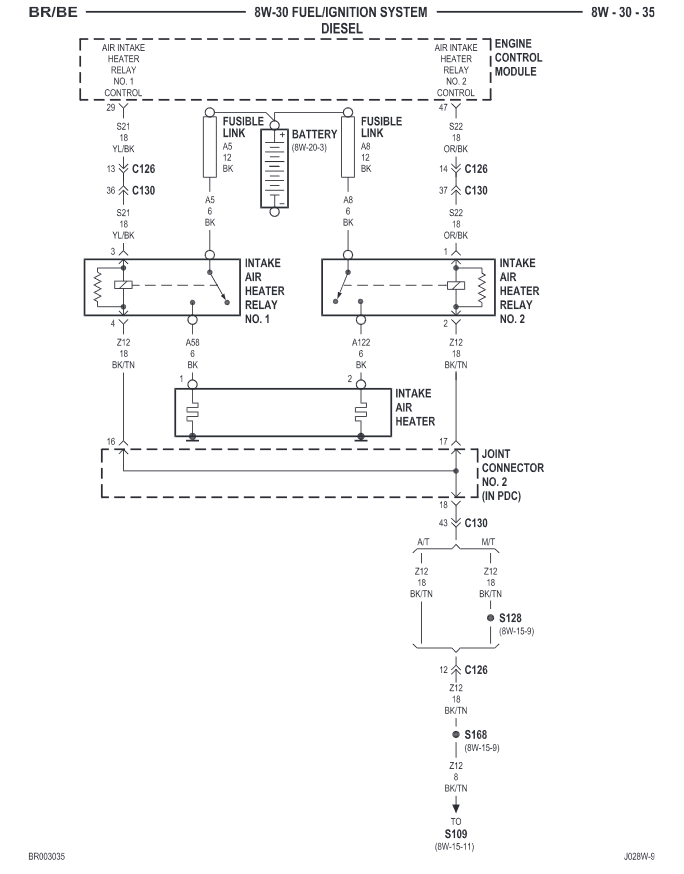

I just used a switch that I had laying around.  A push button momentary switch would work well.  Place it where it is convenient to use.  The switch can be light duty, as it only operates the coil portion of the intake heater relays (less than 500 milliamps of current).
I disconnected terminal # 1 (OR/BK wire) on relay # 2 and terminal # 3 (YL/BK wire) on relay # 1.   I sealed and taped the ends to protect them for future use.  I provided a light gauge wire (18 gauge) from an unswitched source, through a 5 amp fuse, and then to the momentary control switch.  From this switch, I continued with the 18 gauge wire to the coils of both intake heater relays.  Wired this way does set DTC P0380 and P0382, but it does not illuminate the MIL
From this point on, you can be the boss and use the intake heaters when you feel it is necessary.

The ECM controls when the intake heaters operate.  If the ambient air temperature falls below 60° F, then the ECM will command both intake heaters to operate for a determined amount of time when the ignition switch is turned on.  After the engine is started, the ECM will cycle the intake heaters (one at a time alternately - called post cycling) until either the vehicle speed exceeds 20-25 mph, or engine coolant temperature reaches a specific value.
The air intake heaters exist primarily for emissions and occasionally they are needed to assist in starting a very cold engine.

Also is there a fuse or anything I could disconnect or the time being that would disable the grid heater complete until I get around to wiring a switch like that?
No fuse, but you can simply disconnect the two heavy wires that feed each intake heater.  Disconnect them at the positive terminal on the driver side battery.
