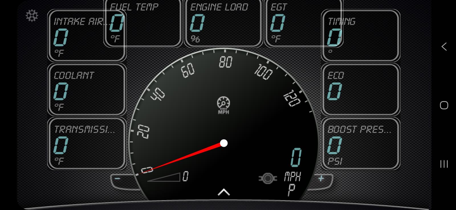

Hello everyone, I spoke a little too soon. I tried my truck for 5 kilometers the other time, and there were no problems. This time I did 30 kilometers and it stopped when I tried to shift from neutral to first gear. It restarts of course, but it's annoying. I don't understand. I wonder if there are two problems, the first the TPS sensor, or the automatic transmission's neutral switch. It's true that I still have a little diesel coming out between lines 3, 4, and 5 and the tubes, but hey, the problem would have appeared earlier...
I noticed when I press the accelerator the response is a little longer, and it lacks power to launch it...
