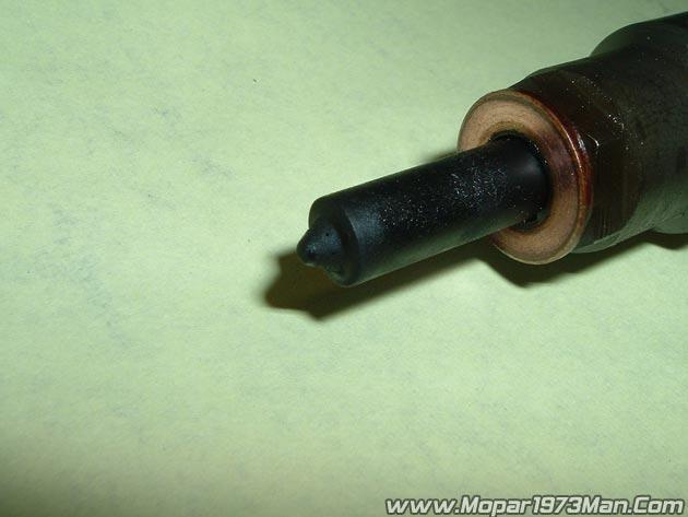

If your using cetane booster you might want to stop that. High cetane actually reduces BTU content of the fuel. Some products actually could soot up the nozzles makes for nasty spray patterns. Here is where 2 cycle oil shines it actually keeps the injectors cleaner. Ill dig up the photo. This is 85k miles on my stock injectors. You can clearly see the holes.
