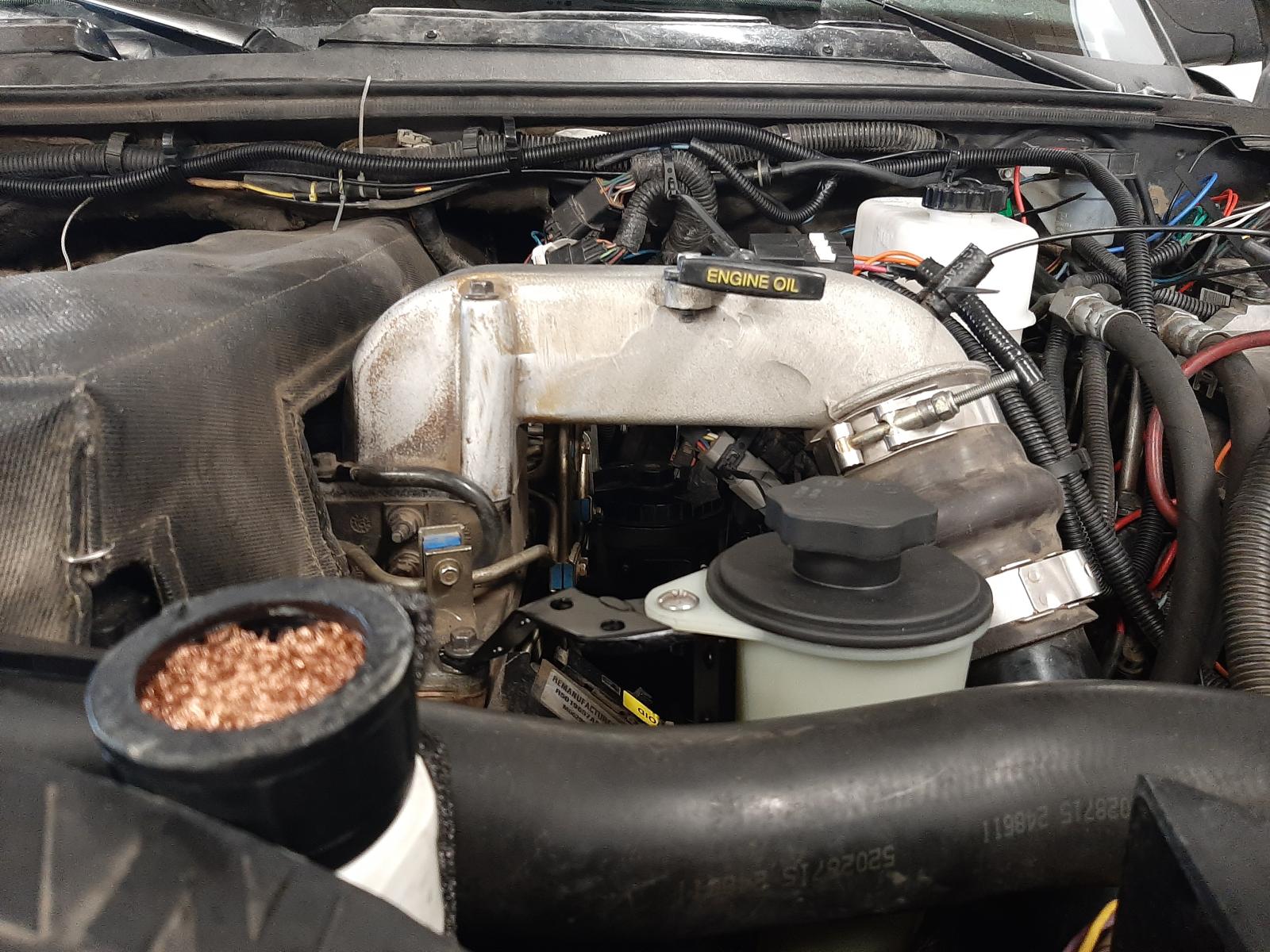

The power steering pump makes me nervous oil in it looks like crude oil. I hate to get a reman and it be worse then I one I have. I did find a link talking about rebuilding it. But the link didn't work I also found a article on this site about hot roding the pump ( drilling out the orfice slightly) and I'll for sure do that. Any chance anyone has a working link on how to rebuild these? Or know of a reliable aftermarket pump.

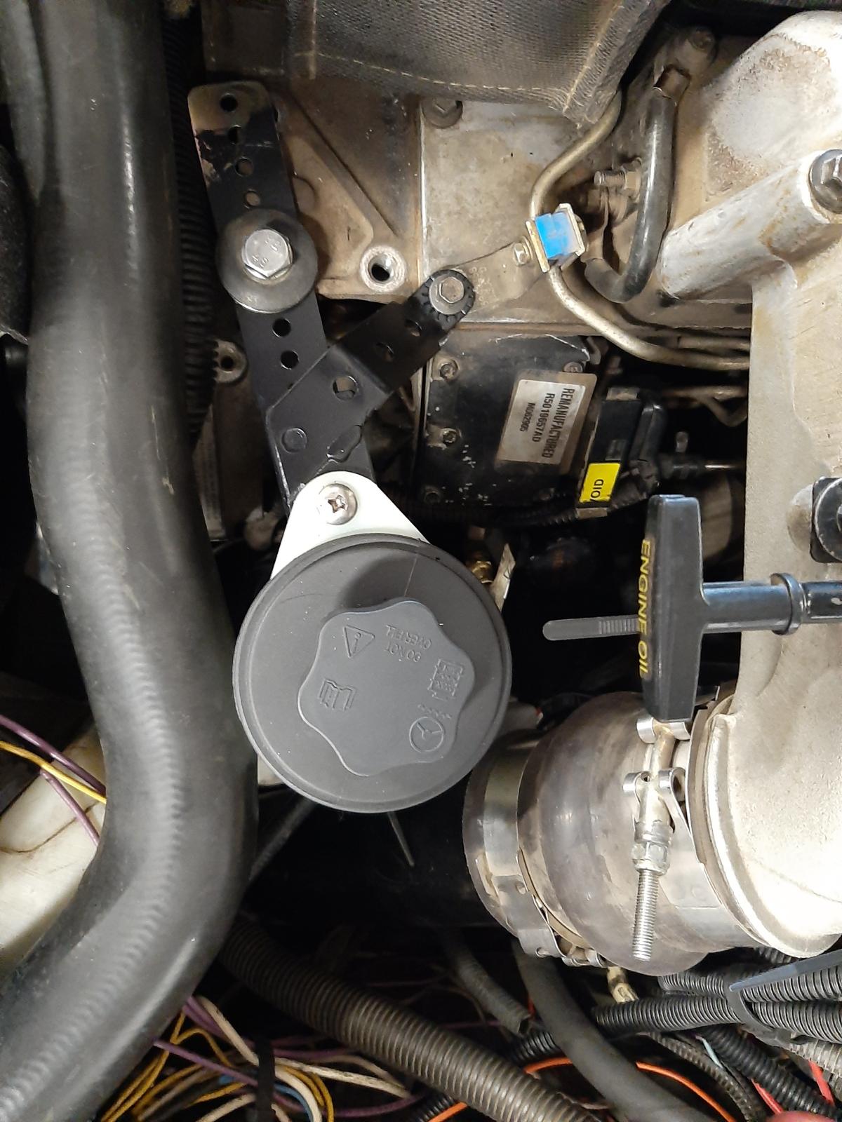

You may want to consider @Mace 's vacuum pump removal / direct mount power steering pump / remote reservoir conversion. The vacuum pump would be replaced by a small electric vacuum pump. I did this conversion myself and I a very happy that I did it. The best part of this conversion was a far better performing power steering pump, a see-through remote power steering reservoir that is very accessible, and the elimination of the gear-driven vacuum pump / power steering pump combination.
I went one step further and remounted the APPS throttle control from the engine onto the brake booster / master cylinder mounts.
The first two photos are my truck and the third photo is Mace's truck.
