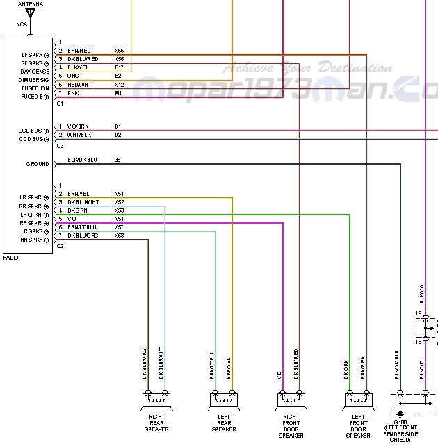

Yeah Dodge and there strange wiring schemes. I'll list out the positive and negative wiring for each speaker. You can see I cut the factory OEM speaker plug off and wired in the new blade style terminals. Be aware of the polarity of each wire and speaker lug. In this set, the Kicker makes the ground with a black strip, and the positive lug is marked red.
Left Front + Dark / Green
Left Front - Brown / Red
Right Front + Violet
Right Front - Dark Blue / Red
Left Rear + Brown / Yellow
Left Rear - Brown / Light Blue
Right Rear + Dark Blue / Orange
Right Rear - Dark Blue / White

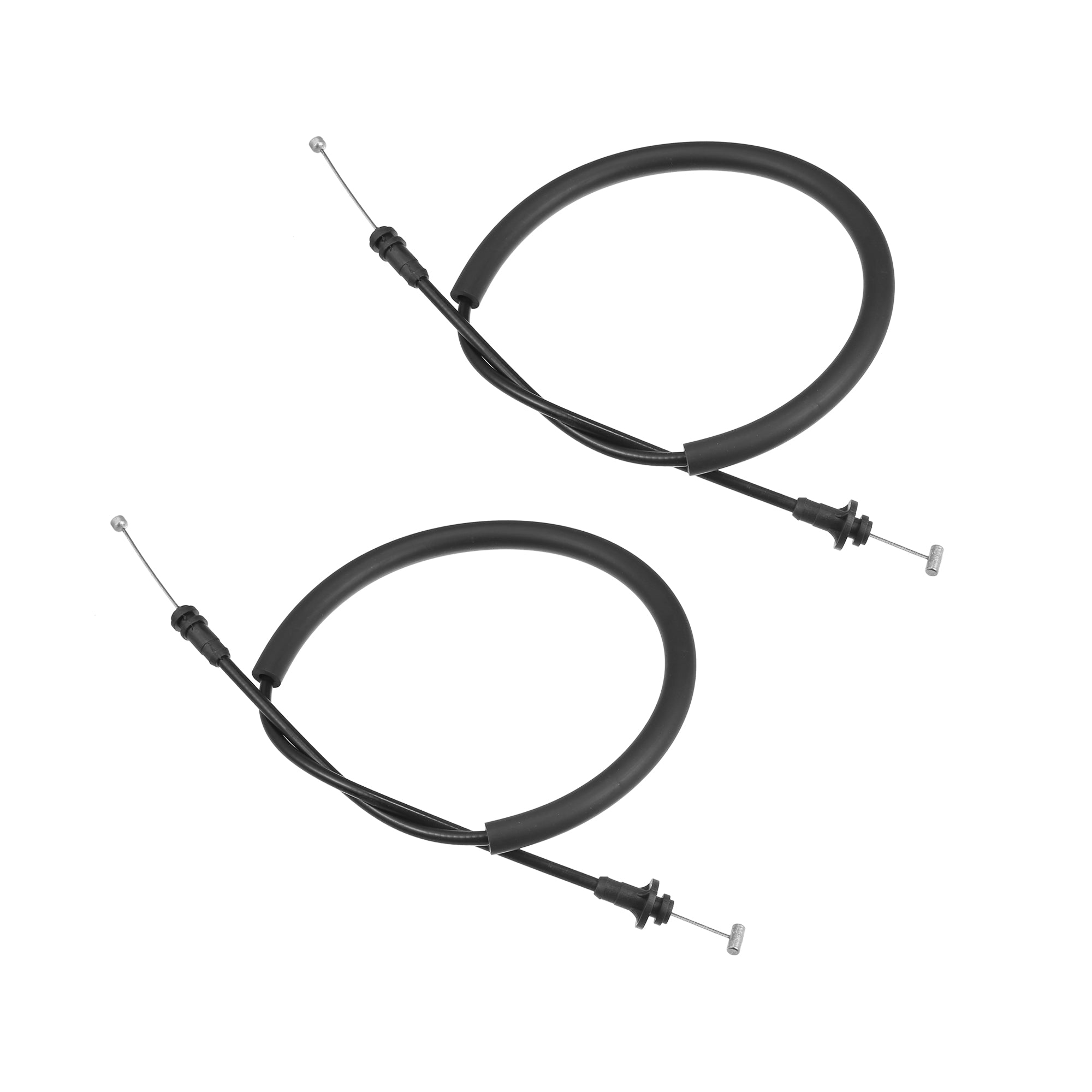

This turned into a problem child to a degree. My driver's side rear door release cable for the inside door latch broke at both ends of the cable. Urgh! I'm going to repair the end hopefully with super glue and atime to till I can order the right cable. 20+ year old plastic is brittle. I've got to pull my dask bezel, and I'm sure more of it will break now, too. Argh!
Use plastic weld. Stuff holds real good!
I found new cables for a pair for the left and right rear door for just under 30 bucks.
