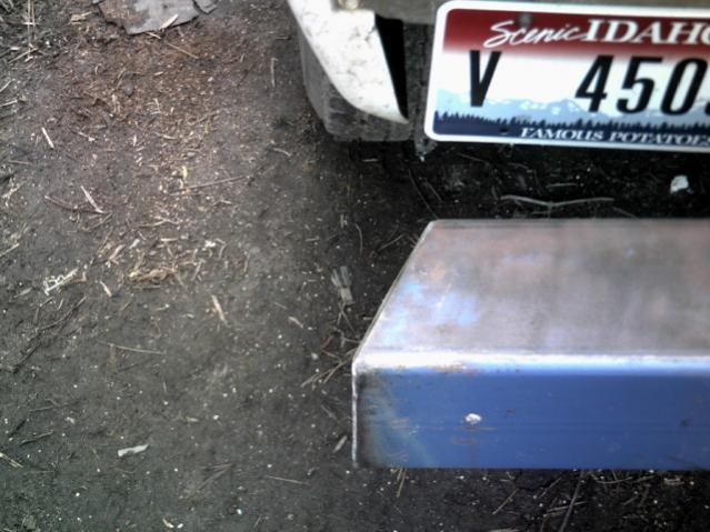

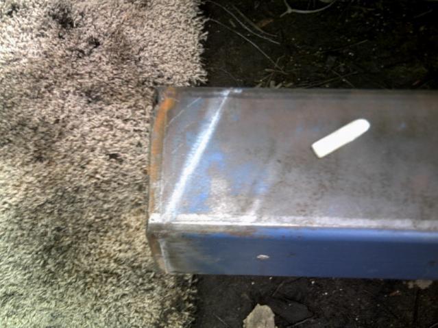

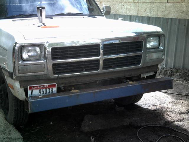

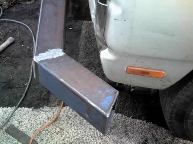

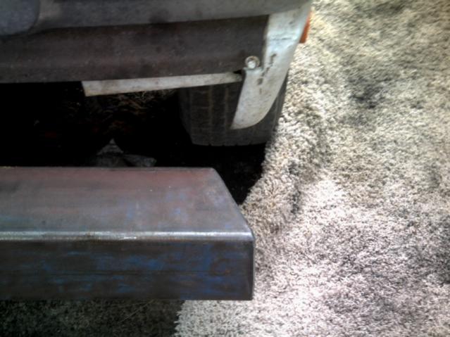

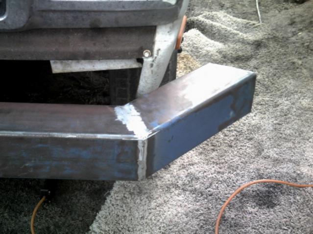

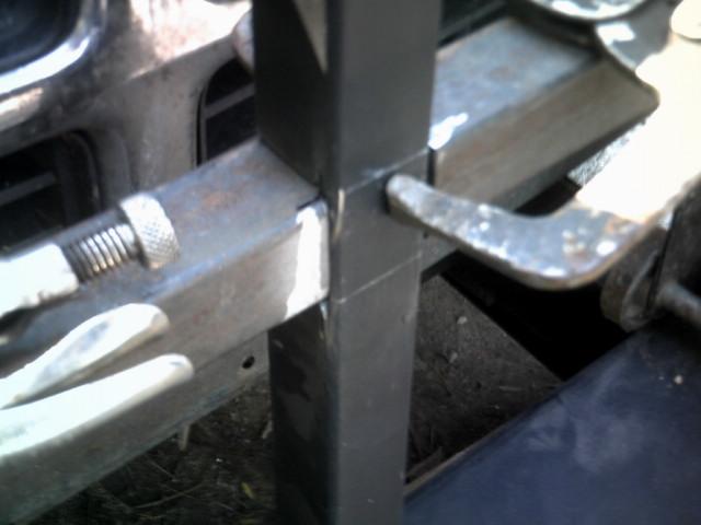

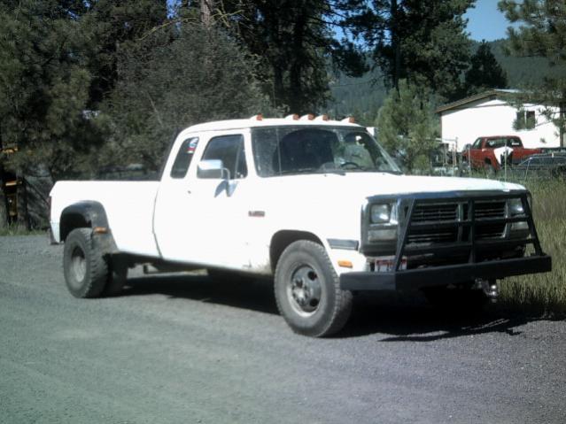

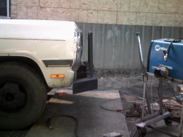

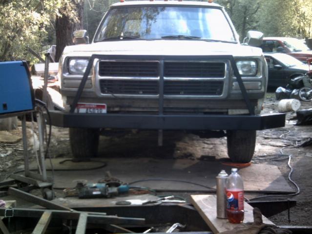

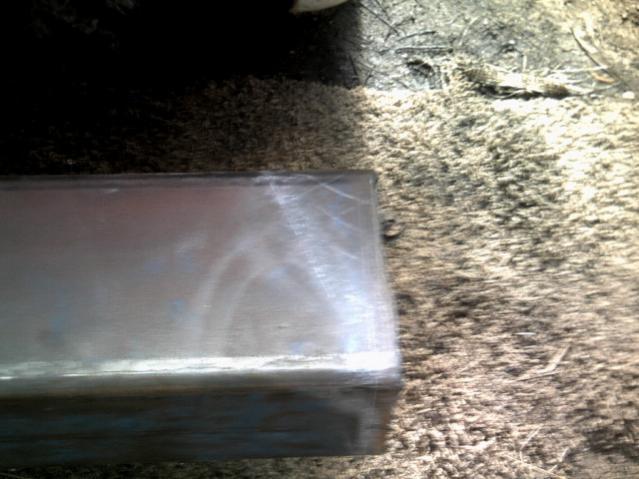

I'm working on building a "5 MPH" bumper for the dually. The unit is made of 5"x5"x3/16" square steel tubing. The project will take me a couple of weeks to finish, but from the progress I've made so far, I'm really happy with the results. I had to stop at this point due to beer overload LMAO! I'm not finished with it by any means. Any input is appreciated Posted Image.

    Look like a good start on a deer strainer...

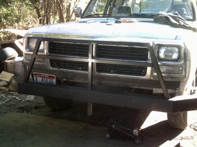

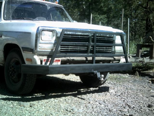

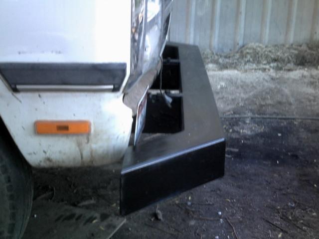

    More pics, but I'm still not done

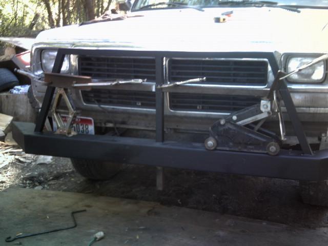

Thank you for your input and pics flagmanruss! Channel iron is good stuff to use for a bumper, depending on thickness. Sounds like you've got some pretty thick iron for your unit. My bumper is only 3/16" thick, but is tubular. I use 1/2" Grade 8 genuine Caterpillar bolts and nuts to hold the bumper to the frame, 4 bolts per side. I have 5/8" Grade 8 Caterpillar nuts and bolts if the need arises, but after I'm done with the gussets on the bumper, I may not need the 5/8" bolts :) At this point, my dad(who has a tendency to overbuild stuff) and I feel like the frame is the weak point. I'll be addressing that in the future. Thanks again guys!

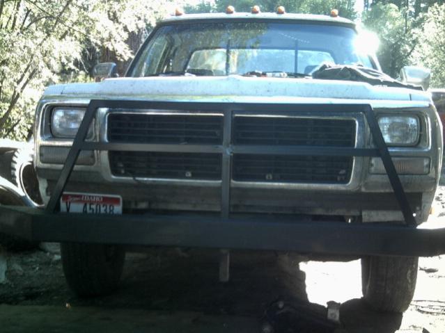

What's nice about it is the upper tubing is not just welded to the top of the main bumper it actually passes through the main tube and is welded at both end giving some serious strength. Boy has the skills to weld that is for sure. :smart::thumb1::hyper:

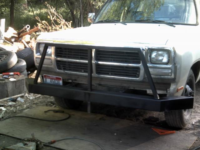

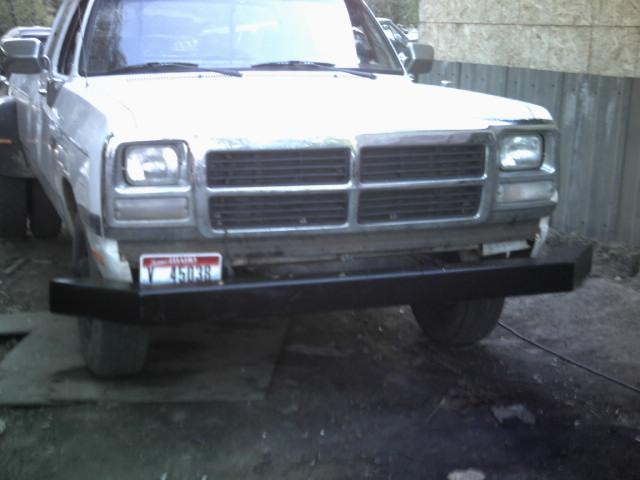

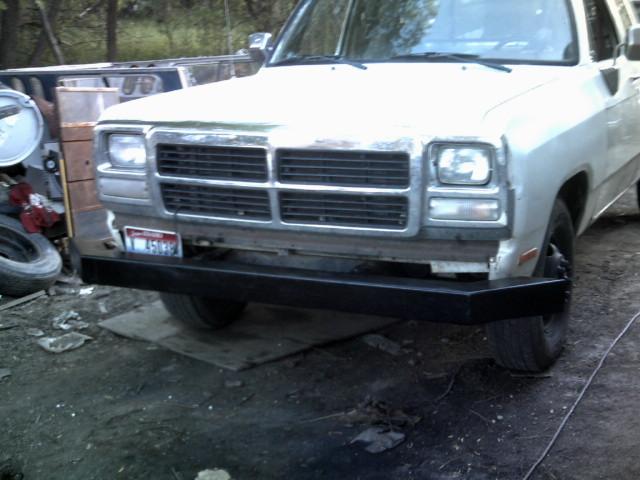

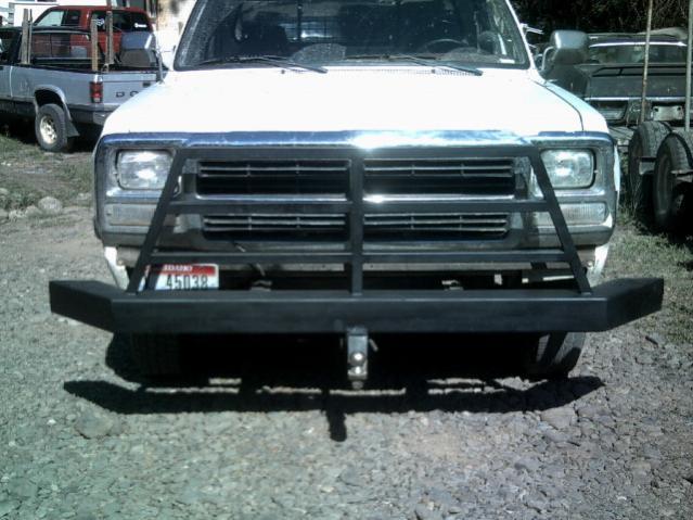

Finally made some more progress on the bumper. I really like how its coming along, and I'm almost done with it :)post-11025-138698179301_thumb.jpg
I like the front mounted stinger... :thumb1: Be really good for your trailer for stuffing in tight places... :smart:
