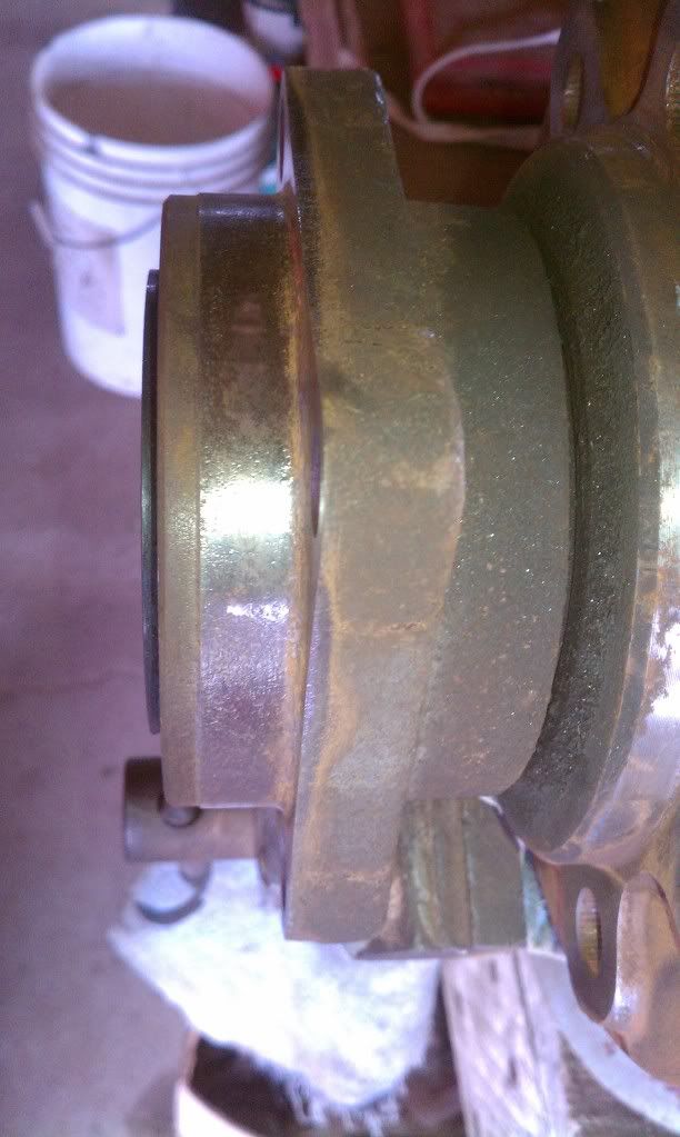

Prep the knuckle area.
Posted Image
Finished product.
Posted Image
Now, who was paying attention and realized what I did wrong? I just realized it a little while ago.
Dust shields. Do I need to take this apart and put in that shield and the spacer? I don't want to, but if I need to, I will. I have not torqued anything up yet, just tightened.
