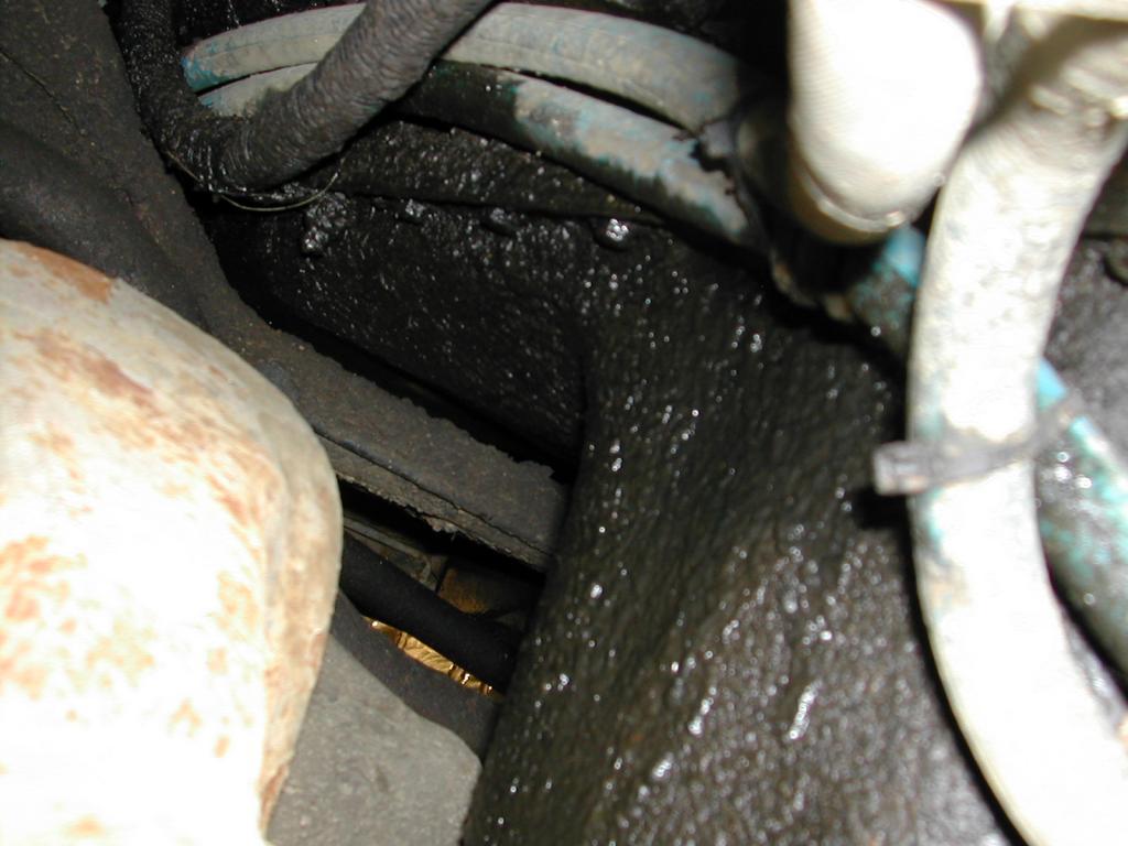

Walking out into the street, I noticed this trail of big drops of fluid down the street.. Following them visually, they went straight into my driveway (where I was backed in, yesterday) to a big puddly wet spot.. I then looked under the truck on the street and BAM! Big puddle.. Went to unhook the trailer and noticed the front of the trailer, the tongue, chains, and back of the truck were all covered in trans fluid (initial inspection.)
I made a couple trips/deliveries, one being 118mi round trip.
Sunday morning, I checked the hitch, chains, etc., before setting off and all was dry/dusty.
So something happened over the course of yesterday, in making a second 118mi round trip and a couple short local ones..
I'll have to get under there and clean everything off so I can see where it's coming from...
:banghead:
- - - Updated - - -
UPDATE:

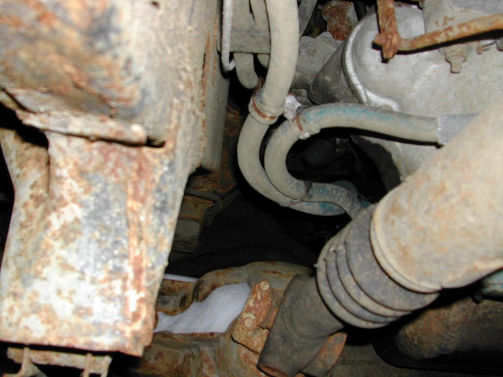

found the leak...
http://forum.mopar1973man.com/attachment.php?attachmentid=4506&d=1348536821
However, I can't seem to stop the leak. I've removed the fitting, checked it and the pipe. I don't see or feel any burrs or anything.. I reinstalled the line and tightened the hell out of it.. Still leaks..
So, tomorrow, I'm gonna have to bypass this block-mounted cooler..
Anyone (with an auto trans) ever bypass the block-mounted cooler and only run a front-mount trans cooler? Suggestions on doing so?
Thread on CF somewhere for doing it. Only downside I remember is if it's really cold as its an exchanger to help warm the tranny fluid :)
well, we dip in to the single digits sometimes in winter, but not often. I'll cross that bridge when I get there, I suppose. ;)Amazing how hard it is to find 1/2" transmission hose... I used a piece of heater hose in the interim, until i find trans hose that big. Hopefully by the weekend. Otherwise, the truck was inoperable, as the leak was that bad!
