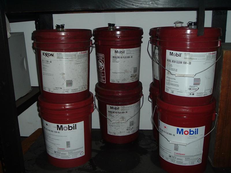

I've been running 15w-40 Mobile year round with winter temps as low as -20*F or so. I run the very same oils the bigger diesel truck run. :wink:post-2-138698196566_thumb.jpgAs for your extreme cold up there I would opt for a 0w or 5w for cold starting but I'm not a huge fan of synthetics oils.
