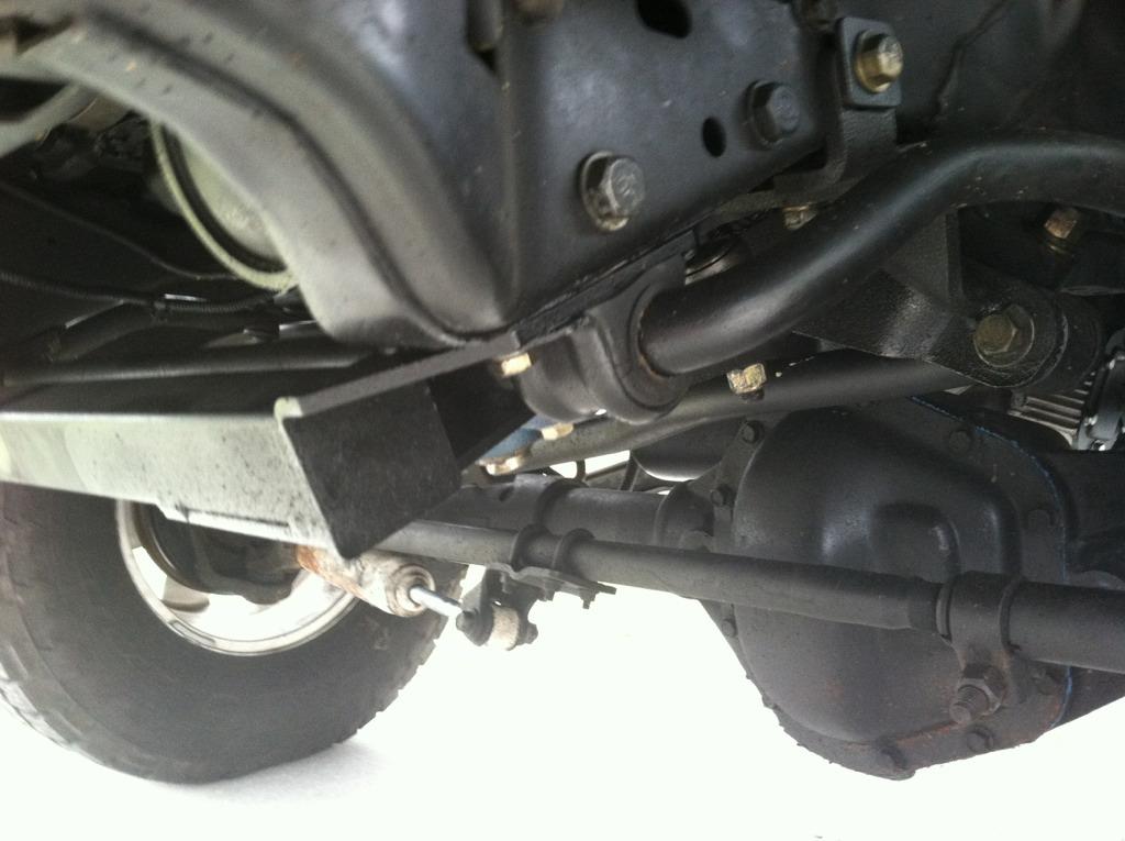

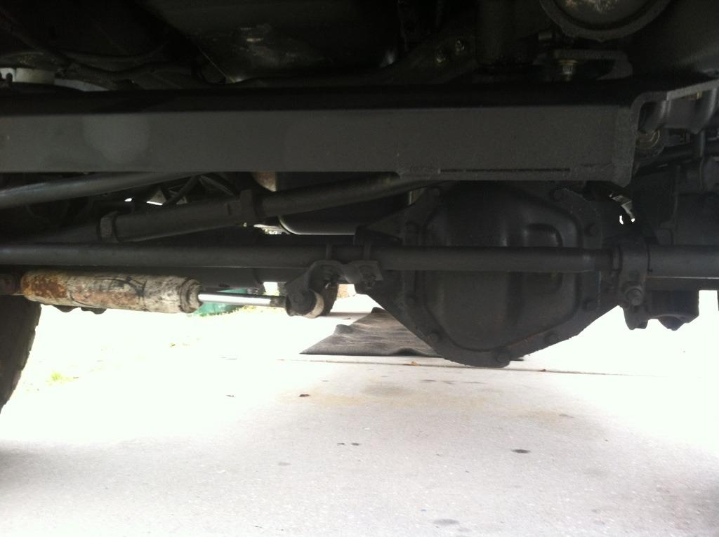

Here is a pic of my truck with the brace, 98-99 HD steering and BD 3rd gen track bar.[ATTACH]5092[/ATTACH][ATTACH]5093[/ATTACH]
