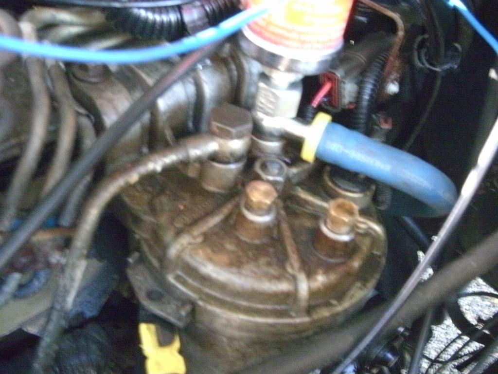

[ATTACH=CONFIG]5458[/ATTACH]thanks going to[ATTACH=CONFIG]5459[/ATTACH] shoot some pics too
The 1/8 plug on the left side of the first pic, just above the yellow drain, is on the filtered side, the plug on the right, just below the big input line is pre-filter, if I understand correctly. On the second pic, the banjo bolt on the right is the inlet to your VP, and the one on the left is the overflow valve, to which the return line from the VP is attached.
Here's mine, which is identical, except I added a long 1/8 in extension for when I hook up a FP test gauge it makes it easier to thread it on there. post-10082-138698201585_thumb.jpg
