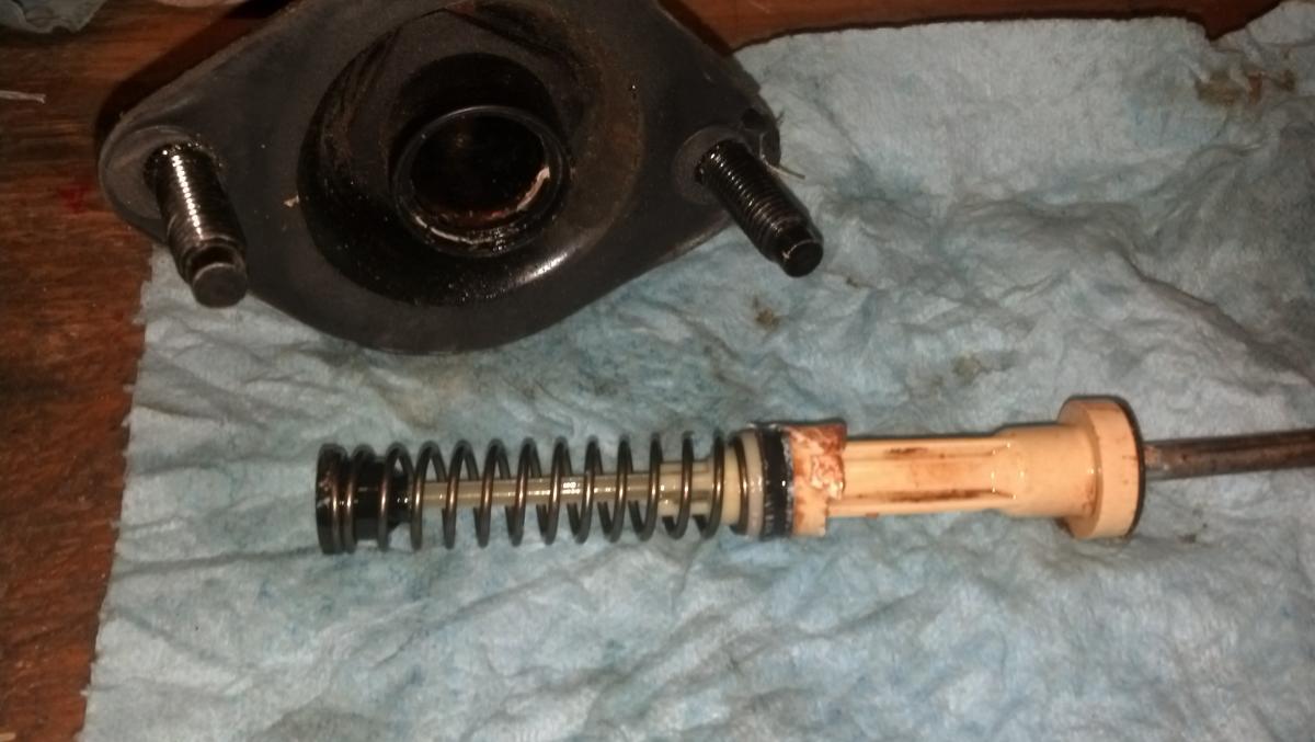

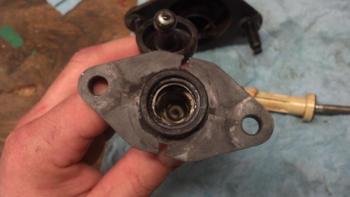

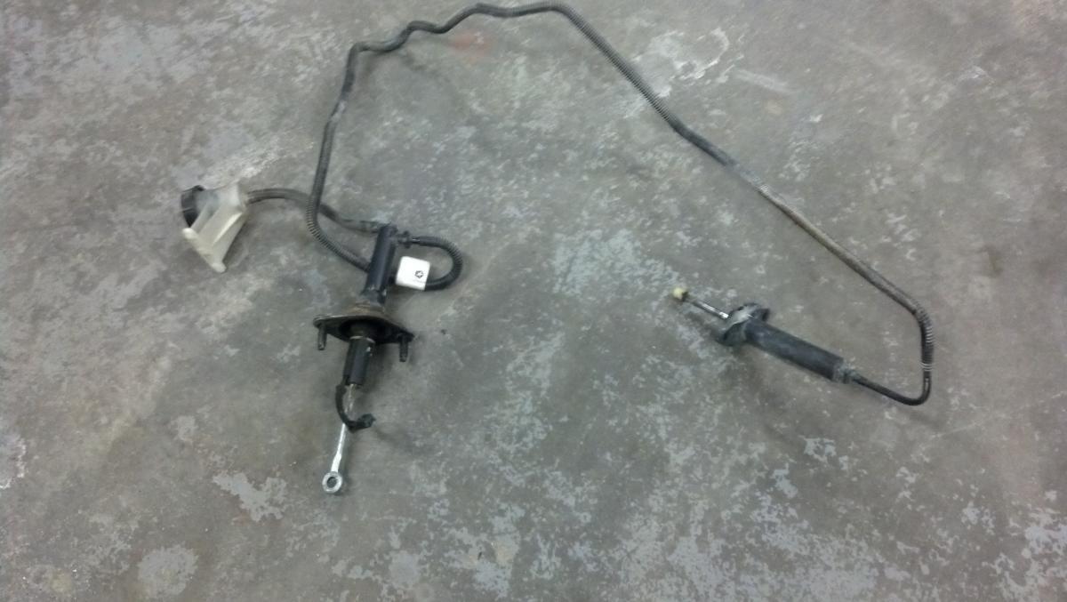

I ended up taking orily china stuff back and got them from carqwest, box says made in 7 county's. took it out of box and it says made in USA.  and part numbers match with what I took out. Not sure if factory is plastic or metal, If plastic then I guess I got lucky and parts are original with life time warranty. Or someone changed them once before me and got them from carqwest too. Attached are new carqwest boxes and old parts.

As for mine I've replaced it twice now over 240k miles. But as for after market clutches it works just fine with my Southbend Clutch and no issues as of yet. First one wore out like you said it would self engage. The second one started leaking fluid in the cab and sucking air back in making it a requirement to pump the pedal to get the clutch to disengage properly.
